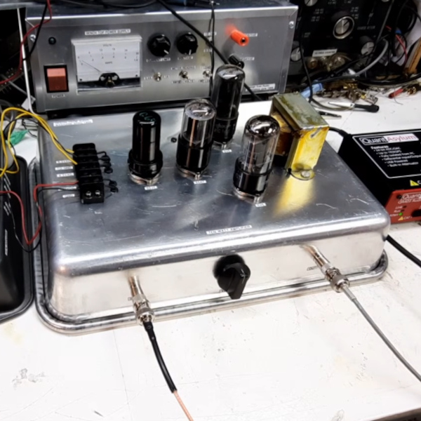

The problem with tube based audio is that it has so often been hijacked by people for whom the bragging rights of having a tube amplifier outweigh the benefits, or the sheer fun of building the thing. [Bettina Neumryr] makes a speciality of building projects featured in old electronics magazines, and her latest, a tube amplifier from 1955, is a fantastic antidote to the gold-plated silliness of audiophile tube amplifiers.
Design wise it’s relatively straightforward, with a preamplifier before a two-tube transformerless splitter circuit driving a push-pull output. She dives into the circuit a little, noting its feedback circuit to the cathode of the first splitter tube. There’s an accompanying power supply, a classic tube rectifier design that incorporates a hefty low-pass filter with a giant choke.
We particularly like her choice of chassis — while it’s possible to pay silly money for a tube chassis in 2026 she’s taken a much more down to earth approach with a pair of baking trays. We’re being honest here, they look surprisingly good. Component choices are limited by what’s available so most parts come from the junk box including the output transformer which causes her issues later. There’s a lot of mumbo-jumbo about tube amplifier layout, and she wisely sidesteps some of it.
The result after a few mishaps and a bit of unintended oscillation, is an amp which shows promise, but has distortion due to that transformer. We think she’ll have no problems sourcing a better one, which should bring that distortion figure into the acceptable range. You can watch the whole video below the break, and if that’s got you hooked, you can see one of our own youthful follies.

  3. Did you try reversing the connections on the secondary of the output transformer? It sounds as though you were getting positive feedback, not negative. A good way to build an oscillator!
  4. Love the idea of using the baking sheet as a chassis. Looks great and you can drill holes in the lips to mount it into a cabinet.
  5. Did you try reversing the secondary connections on the output transformer? Positive feedback instead of negative feedback gives you an oscillator instead of an amplifier! No feedback at all increases the percentage distortion rather a lot.

  7. The 60 Hz hum problem could probably be minimized by moving around the filament wires until it gets better, or injecting a small amount of filament voltage into the signal path, or moving or shielding the signal path wires, etc.. Another possibility is that there’s ripple in the B+ supply, which could be improved with a bigger capacitor. (That’s not likely since that would be 120 Hz.) She did twist together the filament wires, which is good practice.
    Interesting to see the squegging waveform.
    The resistance of the transformer windings is not a good indication of the impedance transformation the transformer should perform. Feed an AC signal through the transformer and square the ratio Vin/Vout to get the intended ratio of input to output impedance. For good efficiency the DC resistance on the primary should be half or less than the plate resistance of the 6L6, and the secondary’s resistance should be half or less the load (speaker) impedance. Her chosen transformer appears to be adequate but not excellent; given that she didn’t really have much choice in the matter she did OK.
    The second harmonic distortion could be improved by trimming the R10/R11 ratio. The RCA Receiving Tube Manual suggests that an amp like this should be capable of 2% distortion at 30 Watts, but that requires a 400 V plate supply, a separate 250 V screen grid supply, and a perfect transformer.
