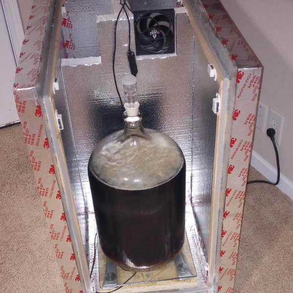

Fermentation is a culinary art where tiny organisms transform simple ingredients into complex flavors — but they’re finicky about temperature. To keep his brewing setup at the perfect conditions, [Ken] engineered the Fermenter, a DIY insulated chamber controlled by Home Assistant for precision and remote monitoring.
The Fermenter build starts with an insulated chamber constructed from thick, rigid foam board, foil tape, weather strips, and a clever use of magnets to secure the front and top panels, allowing quick access to monitor the fermentation process. The chamber is divided into two sections: a larger compartment housing the fermentation vessel and a smaller one containing frozen water bottles. A fan, triggered by the system, circulates cool air from the bottle chamber to regulate temperature when things get too warm.
The electronics are powered by an ESP8266 running ESPHome firmware, which exposes its GPIO pins for seamless integration with Home Assistant, an open-source home automation platform. A DS18B20 temperature sensor provides accurate readings from the fermentation chamber, while a relay controls the fan for cooling. By leveraging Home Assistant, [Ken] can monitor and adjust the Fermenter remotely, with the flexibility to integrate additional devices without rewiring. For instance, he added a heater using a heat mat and a smart outlet that operates independently of the ESP8266 but is still controlled via Home Assistant.

    1. How well does it cool though? Some ale yeasts make an incredible amount of heat when it gets going, and I find it’s difficult to keep it down. Always end up making “steam beer”.
      1. So I usually have to replace two ice bottles about every 24 hours depending on the ambient temperature. For the 2 days or so when the yeast is at its maximum activity, two ice bottles can actually suppress the temperature rise (if desired), but you might have to replace ice bottles every 12-18 hours during that 2-3 day period.
        I’ve found that this design can get the temperature down to about 20 degrees F below the ambient temperature though you’d have to swap ice bottles much more quickly if you were actually trying to hold it at that temp. I usually use this fermenter when I only need to keep the fermenter around 10 degrees or less below the ambient temperature.
        Except in the winter, when the temps in my basement are colder I usually only use this fermenter for ales (which are fermented 10-20 degrees warmer than lagers). It works very well for ales.

  2. I think I’m missing something. Why are air cooling designs popular here? I would have thought liquid cooling/heating would be ideal. Probably costly, but freezing water bottles seems frustrating.
    1. Air cooling systems are much easier and cheaper. Glycol systems exist, but are expensive. These systems are kind of like a portable AC unit that chills a glycol/water mixture which is then run through either a coil submerged in the beer or in a jacket wrapped around the fermenter. It’s possible to build your own glycol chiller, but it’s much more difficult.
      I’ve found the air cooling systems work pretty well and if you don’t like changing ice bottles then you can always get an old fridge or chest freezer and control it with a similar temperature controller. I’ve got another project video on how to do that here: https://www.youtube.com/watch?v=JcBaPzFKumQ
