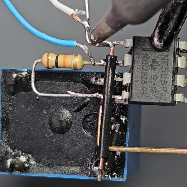

We often marvel at the many things a 555 can do. But [Zafer Yildiz] shows us that it can even take the place of a PCB. You’ll see what we mean in the video below. The timer relay circuit is built “dead bug” style with the 555 leads bent out to provide wiring terminals.
Honestly, these kinds of circuits are fun, but we would be reticent to use this type of construction for anything that had to survive in the real world. Solder joints aren’t known for being mechanically stable, so this is good for experiments, but maybe not something you want to do all the time.

      Have a look at the solder joint @01:45 where the 555 is soldered on top of a relay pin (with apparently even not enough solder)
      For the rest, I did not see the whole video, the editing annoys me. He’s showing the parts multiple seconds (boring) and when he’s soldering (more interesting) he speeds up the video.
    2. Good joints… maybe. A lot of the joints typically shown in vids of this type of construction don’t look particularly good.
    3. I have re-flowed more joints then I can remember, especially inside automotive modules.
      Solder is not a good mechanical connection if exposed to any movement, vibration, or thermal cycling.

  7. I don’t see any back EMF protection diode on that relay. The output transistor in the 555 won’t be very happy without one.
