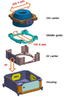

It’s common for modern smartphones to have tiny actuators built into the camera assemblies to handle autofocus and optical image stabilization. Credit: Samsung
