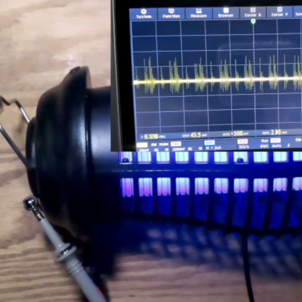

Sometimes the old tricks are the best. [Kevin] learned an old trick about using a ‘scope to sniff RF noise and pays it forward by sharing it in a recent video. He uses an oscilloscope. But does he need some special probe setup? Nope. He quickly makes a little RF pickup probe, and if you have a ‘scope, we’re pretty sure you can make one in a few seconds, too.
Of course, you can get probes made for that, and there are advantages to using them. But the quick trick of quickly and non-destructively modifying the existing probe to pick up RF means you always have a way to make these measurements.
The first thing he probes is a small power supply that is broadcasting inadvertently at 60 kHz. The power supply was charging a bug zapper and, as you might expect, the bug zapper throws out a lot of noise on the radio bands.
If you have an FFT feature on your scope, that is often useful, too, as you can see the results of several interfering signals mixing together. Hunting down interference is a basic skill if you work with radio, and it’s useful even if you don’t.

  3. the “RF probe” is just a regular oscilloscope probe wth the ground lead clipped directly to the probe lead.
    which is about what i expected and so easy to describe in text

  6. The waveform at the end looks like the screen signal itself. You may be able to see a difference by showing different content on the screen.
