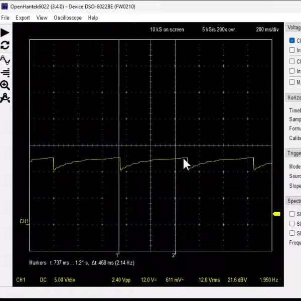

The circuit in question is rather odd at first blush. The BC547 NPN transistor is hooked up between an LED and a resistor leading to a 12V DC line, with a capacitor across the emitter and collector. Meanwhile, the base is connected to… nothing! It’s just free-floating in the universe of its own accord. You might expect this circuit to do nothing at all, but if you power it up, the LED will actually start to flash.
The mechanism at play is relatively simple. The capacitor charges to 12 volts via the resistor. At this point, the transistor, which is effectively just acting as a poor diode in this case, undergoes avalanche breakdown at about 8.5 to 9 volts, and starts conducting. This causes the capacitor to discharge via the LED, until the voltage gets low enough that the transistor stops conducting once again. Then, the capacitor begins to charge back up, and the cycle begins again.
It’s a weird way to flash an LED, and it’s not really the normal way to use a transistor—you’re very much running it out of spec. Regardless, it does work for a time! We’ve looked at similar circuits before too. Video after the break.

    1. Makes more sense to replace the transistor with a real zener then. It would be more durable. The other diode in the npn might be integrated into the LED? Might be worth looking into to see if it will oscillate.
      1. The transistor still exhibits gain when using the E-B junction as a C-B junction. It will just have a horrible breakdown voltage and a really poor hfe.
  1. LOL. Repeatedly putting a typical transistor junction into avalanche is a great way to put a hole in it … and not the kind that you want.
    1. Needless to say that all transistor manufacturers tell you to avoid this.

  5. Interesting that the the avalanche mechanism can be used in reliable ~10V “zeners” (actually avalance diodes). But when reverse biasing the emitter-base region of BJT’s it can degrade gain. This is due to
    generation of recombination centers at the silicon/oxide interface, which increases base current and lowers transistor gain.
