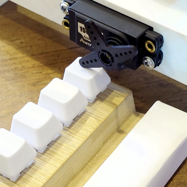

Remote control is a wonder of the age, we press a button, and something happens as if by magic. But what happens if there is no remote control, and instead a real physical button must be pressed? [What Up TK Here], who regular Hackaday readers might just recognize, had just this problem, and made a remote control button presser.
It’s a 3D printed frame which we’re told is designed for a specific item, on top of which is mounted a hobby servo. Rotating the servo brings the lever down on the button, and the job is done. At the user end there’s a button in a printed enclosure that’s definitely not a knock-off of a well-known franchise from a notoriously litigious console company.
This is all good, but the interest for other projects lies in how it works. It’s using a pair of ESP32 microcontrollers, and instead of connecting to an existing WiFi network it’s using ESP-NOW for simplicity and low latency. This is a good application for the protocol, but as we’ve seen, it’s useful for a lot more than just button pressing.

It’s not as bad as it sounds. I have a coffee machine sitting in a cabinet but with the on-off button near the rear of the machine (what was Jura thinking?). This finger robot switches it on every morning at 6, that’s all. When unused for 5 hours the machine switches off automatically so this is the only function I needed as Jura omitted a clock function.
So depending on the purpose, these cheap finger robots can do their job very well.

My thoughts exactly. I used an SSR and soldered two leads to the microswitch. ESP32 signals the SSR to connect, which, presumably grounds the signal on the target microcontroller (I really don’t have to care!), and button pressed. I don’t need ESPNow, it triggers via a local MQTT server. There is a slightly perceptible lag. Very little. Means I only use 1 ESP in my button presser setup, but my phone becomes my trigger, and it works from anywhere in the world assuming you have satelite internet! Not only my phone though, anything that can speak MQTT can be a trigger. Homeassistant can now easily automate this button press so I don’t need a remote trigger. Homeassistant is the remote trigger, and it happens automatically based on other devices connected to homeassistant.
