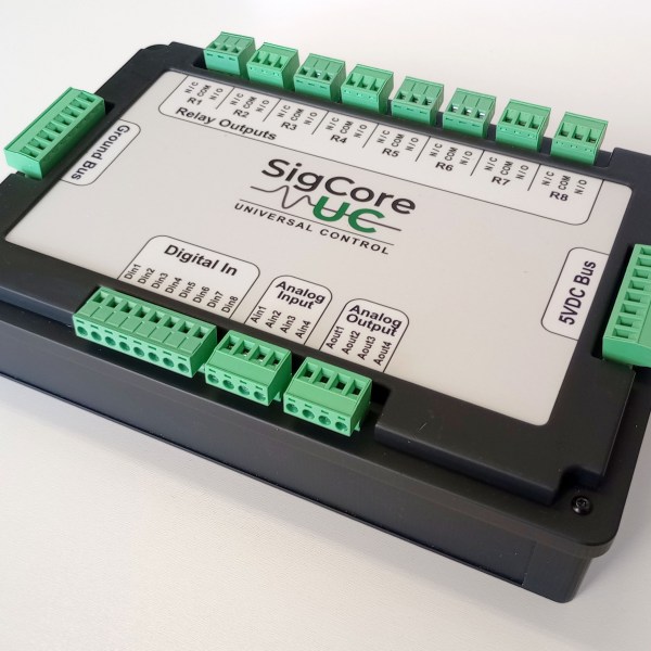

Recently, [Edward Schmitz] wrote in to let us know about his Hackaday.io project: SigCore UC: An Open-Source Universal I/O Controller With Relays, Analog I/O, and Modbus for the Raspberry Pi.
In the video embedded below, [Edward] runs us through some of the features which he explains are a complete industrial control and data collection system. Features include Ethernet, WiFi, and Modbus TCP connectivity, regulated 5 V bus, eight relays, eight digital inputs, four analog inputs, and four analog outputs. All packaged in rugged housing and ready for installation/deployment.
[Edward] says he wanted something which went beyond development boards and expansion modules that provided a complete and ready-to-deploy solution. If you’re interested in the hardware, firmware, or software, everything is available on the project’s GitHub page. Beyond the Hackaday.io article, the GitHub repo, the YouTube explainer video, there is even an entire website devoted to the project: sigcoreuc.com. Our hats off to [Edward], he really put a lot of polish on this project.

    1. Yeah, that is an odd design choice, I’d definitely want to have analogue pins interleaved with grounds and at least one ground on each digital connector.
        1. I had the same question marks regarding GND and also why only 8x GND for the 16x I/Os. But maybe providing feedback directly via github is more efficient then feeding the trolls here. ;)
      1. sigh not criticising, just commenting and trying to give a tiny bit of advice from my experience of designing automotive diagnostic equipment for a living and the valuable lessons I learned from my mistakes (getting bitten in the backside) when analogue signal integrity was compromised because grounding wasn’t good enough.

      3. Besides the analog signal-to-GND spliting also only 8x GND for 16x I/O could become inconvinient.

    1. That’s a fair comparison at the wiring and I/O level. Where SigCore UC diverges is scope and intent. It’s designed as an industrial-grade control platform, not a fixed-function or project-specific controller.
      In addition to relay and I/O handling, it supports database-backed logging, industrial PID control, universal analog and digital I/O, and flexible analog outputs. It can be applied to HVAC control, but the design is intentionally broader and more precise than a single-purpose implementation.

    I think boards like this need a watchdog in case the Pi hangs. I’m presently working with HVAC logging and need isoalted DI’s.
    A better explanation of the project would help. Where does the 5V come from lol
  3. I don’t know what all the goals of this project are. The box has very nice build quality, and as a platform for interacting with physical hardware with C# and Python, it looks like it’s very nice. But several things are not what I would expect for a controller designed for automation, at least not industrial automation.
    As far as I can see, the box is not DIN rail mountable.
    The “bus” voltage is 5V, not 24V.
    The analog outputs only go from 0-5V not 0-10V.
