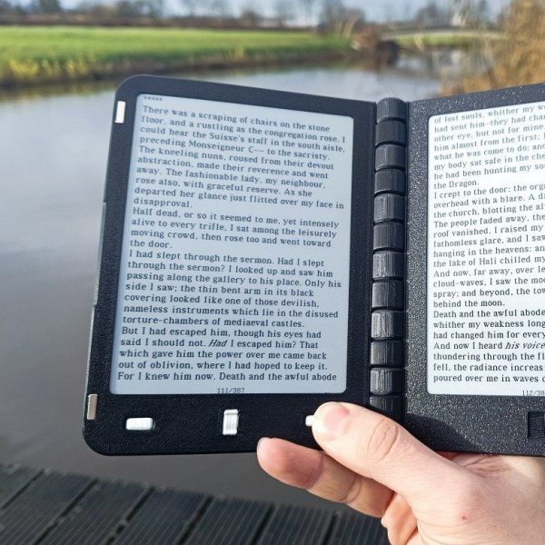

There are plenty of lovely e-readers out on the market that come with an nice big e-paper display. There aren’t nearly as many that come with two. [Martin den Hoed] developed the Diptyx e-reader with such a design in order to better replicate the paper books of old.
The build is based around the ESP32-S3, a powerful microcontroller which comes with the benefit of having WiFi connectivity baked in. It’s hooked up to a pair of 648×480 e-paper displays, which are installed in a fold-open housing to create the impression that one is reading a traditional book. The displays themselves are driven with custom look-up tables to allow for low-latency updates when turning pages. The firmware of the device is inspired by the epub reader from [Atomic14], and can handle different fonts and line spacing without issue. Power is from a pair of 1,500 mAh lithium-polymer cells, which should keep the device running for a good long time, and they can be charged over USB-C like any  modern gadget.
You can follow along with the project on the official website, or check it out on Crowd Supply if you’re so inclined. The project is intended to be open source, with files to be released once the design is finalized for an initial production run.

    1. my Boox ereader has a split-screen feature for this, among many other niceties including a fairly functional browser for those times when what you’re reading only exists as a webpage. not sure I could go back to a “dumb” ereader, and I’m a bit suspicious by the almost complete lack of footage of user interaction in their promo video-driving a responsive UI across two high density displays seems like a lot to ask of an esp32, no?
      1. I’d be surprised if the esp32 couldn’t do it (if programmed properly) – everyone seems to forget how much you can get ‘close to bare metal’ hardware to do when not using 500 different library’s and an interpreted language..
        The esp32 has roughly the same processing power as my university computer had back in the day..
        1. You get very close to the limit due to low pin count and speed. You just don’t have the ability to drive multiple buses at high speed (say, 2 octal buses – no way you’ll be using any hardware accelerators) and IIRC only the ESP32-P4 has a graphics accelerator of some sort
          I’ve seen many projects that use an ESP32 for specific features and an STM32 solely for display
      2. Dual-core 200mHz CPU is no slouch! It can serve up streaming video, it should definitely be able to handle 2 low resolution screens of static text.

    2. Two things. I do love this hack it’s a great design. I am curious how it’s wired across the hinge. It looks like it has a satisfying magnet snap.

        1. If they can power pc fans with contact pins, why can’t they share power charging from one port in the same way when the device is closed? There’s already a magnetic latch. I believe it’s called unit daisy chaining?
      1. If you some sort of contact connector and a battery for that page only, it could transfer the page data only every time you closed and opened the book (flipped the page) and then the power port could be in the side with just the battery and screen and you could charge both of them while closed, because then the contacts could transfer power also. I am not quite sure how the ereader from the article works, but the 3 white dots on the right side of the screen made me imagine this, and also I have little to no experience with these electronics so all this is just imaginative and feel free to correct me if you want
      2. There’s enough bezel here to run pogo pins between the sides to charge through from one half to the other (while it’s closed). I honestly thought that’s what the three white dots on the bottom right were to start with. Wiper contacts in the hinges could also work to avoid ribbon cable flex fatigue, but a laptop style cable through the hinge should do fine, especially as it’s open hardware and repairable.
    1. As long as closing the “book” doesn’t make the cable super taut, I would think ot should be OK for a long time, but admittedly I’m not sure. But at least on a DIY device, you know you have access to soare parts, and cables are cheap :)
