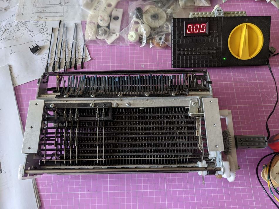

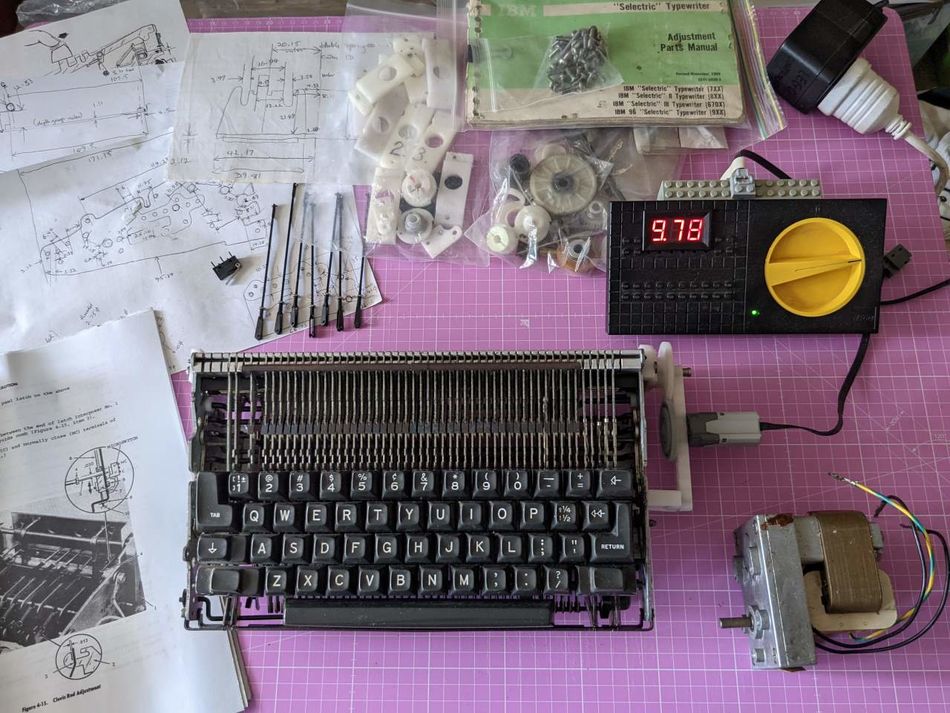

  3. I’ve been working on building a replica of the RCA 70/752 Video Data Terminal keyboard purely from the maintenance manual for the last 5 or 6 years, still not finished but it’s at a (mechanically) powered state, next to do is the mountings for the interposer microswitches. I’ve used other Selectric parts, 3D printed parts, and handmade metal parts to replicate what the RCA engineers did. This terminal came at a time of conjunction of technologies: mechanical, valve(tube), transistors and early IC’s all in the one unit, it’s absolutely wild.

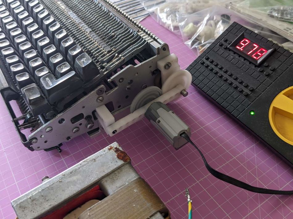

      1. Well the project came about because I had a pile of IBM Selectric typewriters and I really wanted to build a replica IBM 1053 golfball printer. Also it was just my luck I had “inherited” four large fishing tackle boxes of IBM Selectric and other printer parts both NOS and used as well as special tools from a retired IBM Office Products CE.
        So anyway with the removal of a pile of screws the Selectric can be cleanly split into two distinct sections, the ‘power frame’ containing the motor, op shaft (incl cycle clutch), tilt/rotate and print mechanism. The other is the ‘keyboard frame’ containing the keys, interposers and interposer latches. So I get two projects out of one typewriter, woohoo!
        RCA moved the cycle clutch to the filter shaft and drove it from a synchronous motor. They also added a latch interposer to get 7 bits and ASCII from the microswitches. IBM actually provided a bit 7 interposer slot in the Selectric (even in the regular office variety one) but not the latch interposer itself. I made one from a scrap of sheet metal and added a frame for spring loading these, as this is usually done in the power frame.
        These photos are from a couple of years ago. It is being test powered by a LEGO M Technic motor running off a LEGO Train Controller. A vintage IBM AC synchronous motor is at right waiting to have support brackets machined before fitting
        Top https://www.surfacezero.com/g503/data/500/RCA_Spectra_70-752_keyboard_recreation_WIP_01.jpg
        Underside showing homemade 7th bail rod and 7th bit (rightmost) latch interposer (clevises to microswitches attach to these), spring-loading frame and filter shaft with recreated spring clutch and 3D printed bearing brackets. The clutch trip has been moved from the normal centre on a Selectric to the end to be inline with the clutch, waiting for the RCA clutch pawl to be made .
        https://www.surfacezero.com/g503/data/500/RCA_Spectra_70-752_keyboard_recreation_WIP_02.jpg
        Powered filter shaft. Note that some keys eg. Return do not operate through the keyboard interposers but operated against the op shaft in the power frame
        https://www.surfacezero.com/g503/data/500/RCA_Spectra_70-752_keyboard_recreation_WIP_03.jpg
        One day I might write it up as a project, thing is I have three lifetimes of projects I am currently working on… the oldest is one I started in 1978 or so. Can’t hurry these things!
