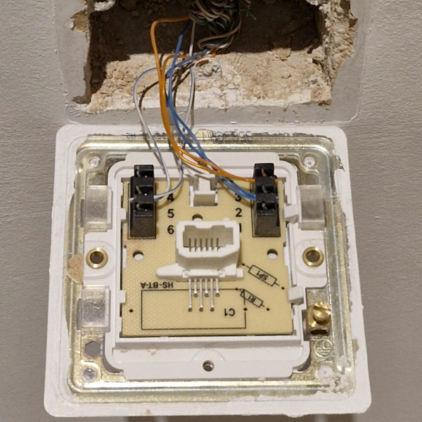

  15. The jack pictured is ugly, with a capital UGH. You should never try to double-punch 2 wires into a single 66 or 110 contact; it is unreliable.
