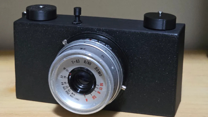

The joy of camera hacking lies for many at the low end of the market. Not working with many-thousand-dollar Leicas, but in cheap snapshot cameras that can be had for next to nothing at a thrift store. [Marek Sokal] has a perfect example, in a 3D printed 35mm camera body using the lens and shutter assembly from a vintage Soviet Lomo Smena 8M.
The build is a work in progress, a printed assembly that holds the 35mm film cartridge, provides the focal plane for the film, and houses the take-up reel. It fits together with M2 screws, as per the Lomo lens.
We like this build, because we can see beyond the Lomo. In a box above the desk where this is being written there is a pile of old plastic snapshot cameras from the 1960s through 1980s, none of which is worth anything much, but all of which have a similar shutter and lens assembly. In many cases it’s not a huge task to do with them what [Marek] has with the Lomo and mount them to a back like this. The LEGO film camera may not have gained approval, but this prove that making cameras of your own is still pretty easy.

    2. Hi there, Marek here. I made this design, cool to see my project mentioned on this site!
      I actually used this project as a means to learn CAD design. In most pursuits of knowledge, I find practical experience that pertains to my life is far easier to digest. I’m happy to report that version 2 and 3 of the prototype look much nicer and have even more features!
      The “special” thing about this design is that it was an experiment on how much image circle I could get on the film. This was information I needed for revision 2 and 3. The frames of this camera went into the sprocket hole and covered some of the rebate text, version 2 and 3 stretch it a smidge further leaving about .25mm on either side of the film – pressure plate keeps it flat.
      One look at the files – if you shoot film – you should be able to see that the frame size is much larger than that of the standard 35mm frame. I appreciate the feedback, but that’s the “special” thing you missed.
