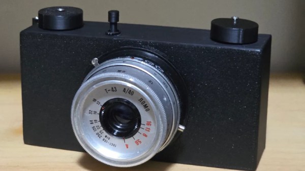

The joy of camera hacking lies for many at the low end of the market. Not working with many-thousand-dollar Leicas, but in cheap snapshot cameras that can be had for next to nothing at a thrift store. [Marek Sokal] has a perfect example, in a 3D printed 35mm camera body using the lens and shutter assembly from a vintage Soviet Lomo Smena 8M.
The build is a work in progress, a printed assembly that holds the 35mm film cartridge, provides the focal plane for the film, and houses the take-up reel. It fits together with M2 screws, as per the Lomo lens.
We like this build, because we can see beyond the Lomo. In a box above the desk where this is being written there is a pile of old plastic snapshot cameras from the 1960s through 1980s, none of which is worth anything much, but all of which have a similar shutter and lens assembly. In many cases it’s not a huge task to do with them what [Marek] has with the Lomo and mount them to a back like this. The LEGO film camera may not have gained approval, but this prove that making cameras of your own is still pretty easy.
