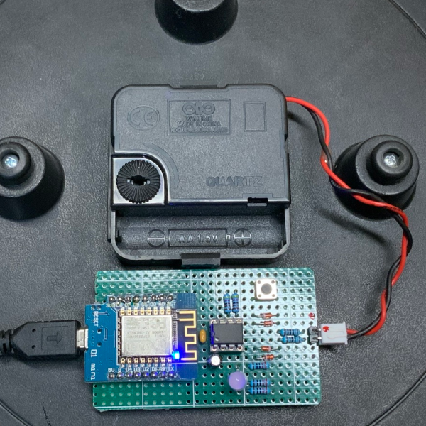

In the realm of first-world problems, your cheap wall clock doesn’t keep time, so you have to keep setting it. The answer? Of course, you connect it to NTP and synchronize the clock with an atomic time source. If you are familiar with how these generic quartz clock movements work, you can probably guess the first step is to gut the movement, leaving only the drive motor.
The motor is somewhat like a stepper motor. The ESP8266 processor can easily control the clock hands by sending pulses to the motor. The rest is simple network access and control. If the network time is ahead, the CPU gooses the clock a little. If it is behind, the CPU stalls the clock until it catches up.
If you’ve ever done a project like this, you know there is one major problem. At some point, the processor needs to know where the hands are now. On initial setup, you can force the issue. However, if the power goes out, it won’t work well. If the power goes out at, say, 8 AM and turns back on at 9 AM, the CPU will be happy to correct the time to agree with the NTP time. The problem is that the processor has no idea that the hands started at 8 AM, so the time will be off.
To combat this problem, the design uses an EERAM chip to store the current time. In the event of a power failure, the CPU knows where its hands are and can adjust accordingly.

  2. An advantage of cheap wall clocks is that they run on batteries.
    The major problem I see here is a USB cable dangling from this clock.
    With some more design effort, the author could have fixed this. There’s plenty of room for batteries.

    2. One way would be to have a low power counter chip count the clock ticks from the original electronics. The ESP can then wake once a day, compare the count and skip or add a few ticks as needed.

  3. I saw a project once, where they detected as the hands passed a certain point, by use of infrared sensors behind the face shining thru tiny holes, that would reflect off of the back of the hands as they passed. That would at least allow you to verify the time displayed is correct, once the hands reach that point.
    As for power loss, there is this thing called a “battery” that could keep the microcontroller going for quite a while. You could hide at least 2 or 3 16850 cells in the back of the clock.
    1. That’s a neat hack (detecting the hands’ positions). I was thinking “two gray code wheels rotating with the hands behind the dial”, which would be too complicated, as I’d have to design and build my own three-axle shaft (or two-axle for hour and minute hands only).
      Makes me think perhaps flip clocks were simpler to read off of. One could mark the flips with binary code (or gray code) dots and read those with some kind of 8-bit sensor with IR.
      Something like that.
      1. Most of these cheap battery powered wall clocks have a little knob or something on the back for setting the time. Said knob is always connected directly to the clockwork, so all you need is to set the clock to 12:00 and attach your encoder to it.

  4. The one DCF77 clock I took apart uses an infrared LED + photo diode to detect if the handles are in one of, IIRC, 3 specific positions (LED shines through holes in the gears). Since it knows how many steps it took to get from one of these positions to the next, it knows on the second position on which of the three it is. In my case the LED had to be replaced to stop the clock from endlessly trying to find one of the positions.
