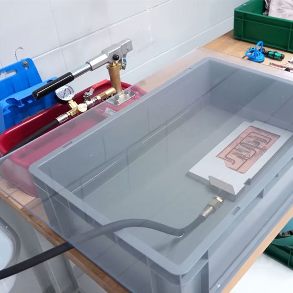

This is why [der8auer] as a manufacturer of such water blocks has now spent a few years investigating the viability of using glass for this purpose. First and foremost is safety, with an early prototype glass water block suddenly shattering without clear cause.
Although normally the water cooling loop is only expected to experience pressures of about 600 mbar, the new glass windows that are now entering mass-production had to be tested to their breaking point. This involves pumping water into a few test blocks until they fail, using the test rig that you can see above.
First the big GPU water block was tested, with the acrylic version breaking at around 8-9 bar, while the glass plate shattered at around 5 bar. The failure mode was also interesting, with the glass plate shattering into fragments, while the two acrylic plates tested failed in a completely different location and manner.
A smaller water block with glass window failed at about 10 bar, demonstrating mostly that smaller glass windows are a lot sturdier. Effectively glass windows in water cooling loops are viable, and they also do not suffer from e.g. discoloration, but you do give up a big chunk of your safety margin if your water cooling loop suffers a major pressurization event. Which of course should never happen, but we’re definitely looking forward to the upcoming field trials of these new water blocks.

  3. And it will still crack randomly. I suspect thermal stress and how the screws create load is way more important of a factor than the measly pump pressure. It’s a nice test, but he missed the bigger picture.
    1. He did mention dealing with such random cracking before in samples a long time ago, likely due to defects in the glass. Sadly it’s not mentioned what exactly was done to address this, but on the bright side these glass waterblocks will be premium models for people who can afford a bit of water damage :)

  4. glass weakens with stress. Its why chem labs have to replace glassware before it breaks. You can see the built up stress with a polirimeter or polariscope. Every thermal cycle is going to stress things. Glass is a bad idea unless you can prevent thermal cycling stress from being applied. (Possible) By the video, I wouldn’t trust these guys with glass. Stick with PMMA. Competition has room to move in if they want to make a safe glass version!
  5. I’m surprised they did not screw it to a heater during the test, I would think one side as well as the rim being heated by the CPU/GPU as well as the pressure of the retention mechanism to said CPU/GPU could play a role.
