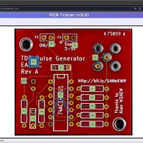

If you want to reverse engineer a PC board, you could do worse than X-ray it.  But thanks to [Philip Giacalone], you could just take a photo, load it into PCB Tracer, and annotate the images. You can see a few of a series of videos about the system below.
The tracer runs in your browser. It can let you mark traces, vias, components, and pads. You can annotate everything as you document it, and it can even call an AI model to help generate a schematic from the net list.
This is one of those things that you could do without. Any photo editor could do the same thing. But having the tool aware of what the photo is showing makes life easier. The built-in features are free, but if you use the AI tool, he says it will cost you about a half-dollar per schematic (paid to the AI company).
Even if you don’t think you need to reverse-engineer anything, you may still find this useful if you are trying to understand a board for repair. We’ve had a good Supercon/Remoticon talk about PCB reverse engineering you can watch. If you want to see what a real X-ray of a board looks like, here you go.

    2. As the developer, I totally understand concerns about browser compatibility and about file permissions. With that in mind, a desktop version is currently under active development. It’ll have a lot more features, including support for any number of PCB layers, support for surface mounted ICs and additional AI intelligence features.

  3. I am trying to like this. I like the goal of the tool, and he clearly put quite some thought and effort into this.
    But I’m having difficulty in comprehending the benefits of this, compared to just using KiCad.
    In KiCad, you can also import background images and draw over them. Both with real footprints from KiCad’s library, and with copper tracks. One of the main questions is: What do you have when you’ve done the hard work? In KiCad, you’ve got a fully reverse engineered PCB, and you can easily create Gerbers from it, or add the schematic. With this tools, I’m not sure what you can do after the PCB has been drawn over. Are there any export functions, or are those not finished yet?
    @51:00 he mentioned an export of the netlist to KiCad, and for hints of how that might work. But this is not how it works at the moment in KiCad. In KiCad a full reverse engineer workflow is sort of:
    Make pictures of the PCB. Picture quality matters. From depopulating the PCB, to sanding off the PCB to expose inner layers (It has all been done and also documented sometimes)
    Do a rough import of the pictures in the PCB editor. Place some footprints on top to get a few references. Draw the PCB outline according to real dimensions. The pictures can be scaled and rotated in KiCad if that’s needed.
    Export the footprints into a program that is good with working with pictures (Gimp, Krita, etc).
    Also import the photographs into this graphics program (This is beyond KiCad).
    You can use export from KiCad as a guideline to reduce distortions from the photographs.
    Use the graphics program to enhance contrast of the photographs.
    Import the improved pictures back into KiCad.
    Build up more of the PCB. Place footprints, retrace the tracks.
    Assign net names.
    Or slightly better: First draw the symbols in the schematic, assign footprints, and “Update PCB from Schematic [F8]” to get the footprints on the PCB. If you do it in this order, there is already a connection between symbols and footprints.
    Draw tracks. Drawing tracks in between footprints on the PCB is still a bit fiddly in KiCad, but it can be done.
    You can assign net names to the tracks. Having different netnames allows KiCad to keep clearances in between different nets.
    You can use: “Update Schematic from PCB” (the other way around from the normal workflow) to get the netlist into the schematic. This does not draw tracks, but it does attach labels with the net names directly to pins in the schematic.
    From there, the schematic can be further cleaned up and extended.
    This is an iterative process. In the end the schematic and the PCB will match each other. On the schematic it’s easy to see whether all connections are “plausible”.
    In the end there should be no DRC violations or missing parts after an “Update PCB from Schematic [F8]”.
    At this moment you have a full working KiCad project. Use it as a start to make a variant of the project, or create Gerbers and order PCB’s.
    There are (probably) a few things this PCB Tracer program can do better then KiCad, but how much is it lacking by having to learn another program, and unknown (to me) export capabilities? Having to redo half the work all over to get it into a PCB design program also reduces the usefulness of this tool.
    So overall, I want to err on the cautiousness side. I do not know enough of this program to really compare it with what can be done in KiCad. (I spend about 15 minutes on the 51 minute video to see some highlights) But I do wonder whether the creator of this tool is aware of the reverse engineering functionality that is slowly being built into KiCad?

      I’m the creator of PCB Tracer. It started out as a little project purely for fun and learning. It remains a very fun to develop and the AI integration has some features that I think are kinda innovative. Anyway, the s/w reached a point in development where I figured I’d make it available –for free– hoping some others might finds it useful. I’ve had some very nice feedback and some complaints. I suppose that’s just the nature of going public with any project. Oh, well…
      Development will continue and a desktop version is coming that will have more capabilities (support for any number of PCB layers, surface mounted component support, and more AI features). KiCad file support remains a high priority goal. But I’ll need to reverse engineer kicad file schema(s) first, since they aren’t published anyplace that I’ve seen.
  4. Hi all,
    I’m the developer of PCB Tracer. It’s a project I started just for fun, exploration and learning. After a few months of coding, it had enough capabilities and conveniences that I figured I’d make it freely available, hoping some people might find it useful. I’ve had enough positive feedback that I think it does have some unique abilities and some are finding it useful.
    As for some of the comments here, I completely understand the frustrations about browser incompatibilities and about requests for KiCad schematics. I am working on a desktop version that will eliminate the browser concerns. The desktop version will also have more advanced features, such as support for any number of layers, surface mounted components/BGAs, additional AI features, and more.
    As for KiCad schematics, I have tried several times and failed to get KiCad schematic generation working. On my TODO list is reverse engineering KiCad file schema(s). I’ve been unable to find them anywhere and think I need a better understanding of the file structures to get KiCad schematics working.

  5. I’m just testing this tool by reverse engineering a power supply.
    I’m finding it very useful and easy to use. The video tutorial explains all the features, so it is easy to get going.
    I quite like the tools for manipulating and aligning the PCB pictures. Adding traces, vias and components is rather simple and intuitive. All in all, a very useful tool to reverse engineer a circuit with little time investment.
