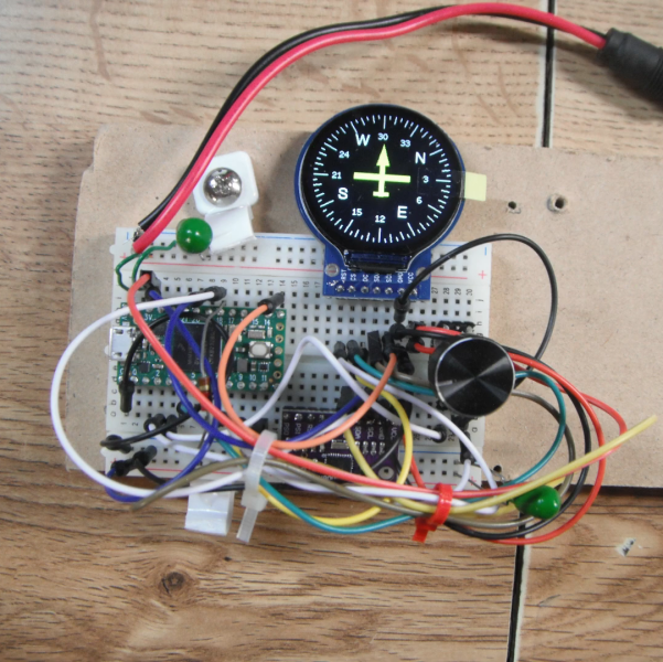

Light aircraft often use a heading indicator as a way to know where they’re going. Retired instrumentation engineer [Don Welch] recreated a heading indicator of his own, using cheap off-the-shelf hardware to get the job done.
The heart of the build is a Teensy 4.0 microcontroller. It’s paired with a BNO085 inertial measurement unit (IMU), which combines a 3-axis gyro, 3-axis accelerometer, and 3-axis magnetometer into a single package. [Don] wanted to build a heading indicator that was immune to magnetic disturbances, so ignored the magnetometer readings entirely, using the rest of the IMU data instead.
Upon startup, the Teensy 4.0 initializes a small round TFT display, and draws the usual compass rose with North at the top of the display. Any motion after this will update the heading display accordingly, with [Don] noting the IMU has a fast update rate of 200 Hz for excellent motion tracking. The device does not self-calibrate to magnetic North; instead, an encoder can be used to calibrate the device to match a magnetic compass you have on hand. Or, you can just ensure it’s already facing North when you turn it on.
Thanks to the power of the Teensy 4.0 and the rapid updates of the BNO085, the display updates are nicely smooth and responsive. However, [Don] notes that it’s probably not quite an aircraft-spec build. We’ve featured some interesting investigations of just how much you can expect out of MEMS-based sensors like these before, too.

    2. Your comments are correct. I have built and tested a 9DOF with magnetometer and it worked quite well except near magnetic objects and motors. (initial calibration was a pain) This BNO085 project was done so I could check out just the gyro portion. I wanted to see how bad the gyro portion really was. That’s also why I put in a 0.5 degree turning threshold so I could try to avoid low level accumulating noise. I also used quaternion math vs Euler to avoid singularity errors. I have yet to do testing and am interested if anyone does do testing with this configuration. BTW aircraft directional gyros also drift over time and typically during level flight I’d just reset the vacuum DG to the compass heading. I was planning on putting this in a RC Tank and the motors would screw up a magnetic compass.
