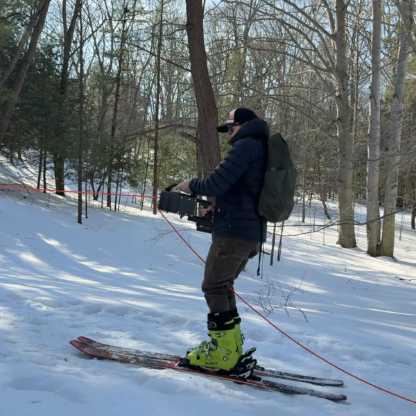

Out of all of Batman’s massive array of tools which turn a relatively ordinary person into a superhero, perhaps his most utilitarian is his grappling gun — allowing him the ability to soar around his city like Spiderman or Superman. [John Boss] isn’t typically fighting crime, but he did develop his own grappling gun of sorts which gives him another superpower: the ability to easily scale snowy hills to quickly get back to the top.
The grappling gun takes inspiration from a commonly used tool called a power ascender, which is often used in industry applications where climbing is required. This one is held in the hand and uses a brushless motor with a belt-driven 3:1 reduction for increased torque. The pulley system, bearings, and motor are all housed in a 3D printed enclosure and are powered by rechargeable Milwaukee power tool batteries. During prototyping the rope intake and output feed locations had to be moved to increase the pulley’s grabbing ability, and with a working prototype he swapped a lot of the plastic 3D printed parts out for metal to increase the sturdiness of the device.
The grappling gun was originally designed for a smaller child to get hoisted up a hill on a sled, but when stress testing the device [John] found out that it actually has more than enough capability to haul even an adult up a hill on skis. As an added bonus, the outfeed for the rope can be put into a bag and used to automatically coil the rope up when he’s done at the hill. Although this is a great solution for a portable rope tow, for something more permanent and more powerful take a look at this backyard rope tow that was built from spare parts.
