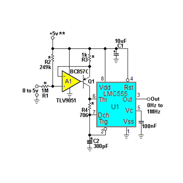

The humble NE555 has been around for over five decades now, and while during that time we’ve seen a succession of better and faster versions of the original, the circuits which surround it are pretty well known. There can’t be anything new in the world of 555s, can there? [Stephen Woodward] claims he’s made a novel 555 circuit, with his 1 MHz linear voltage to frequency converter. Since he’s been in love with the 555 since 1974, we’re inclined to trust him on this part.
It’s visibly the 555 astable oscillator we’re all familiar with, given the addition of a current source in place of the normal charging resistor. This makes for a much more linear sawtooth waveform, but it still doesn’t fix the linearity of the voltage to frequency curve. The novel bit comes in adding an extra resistor between the threshold and discharge pins, with a value calculated for a time constant with the capacitor to match the 555’s own switching delay. This provides the necessary compensation, and gives the circuit its linearity.

“… cuts short the duration of the positive-going timing ramp and thereby the sawtooth period by the same amount that the delays lengthen…”
The tradeoff is that the amplitude of the signal will vary with the frequency, because it’s essentially moving the switching thresholds closer together to kill off the switching delay.
Oh wait, it wasn’t outputting the sawtooth ramp but the square wave. Nevermind.

Could be used at the core of a Widlar Hassler implementation. Peak detector on the front end and a little audio amp on the back into a speacker.
Use the cmos version as the old 555 is good to 100 kHz or so.
