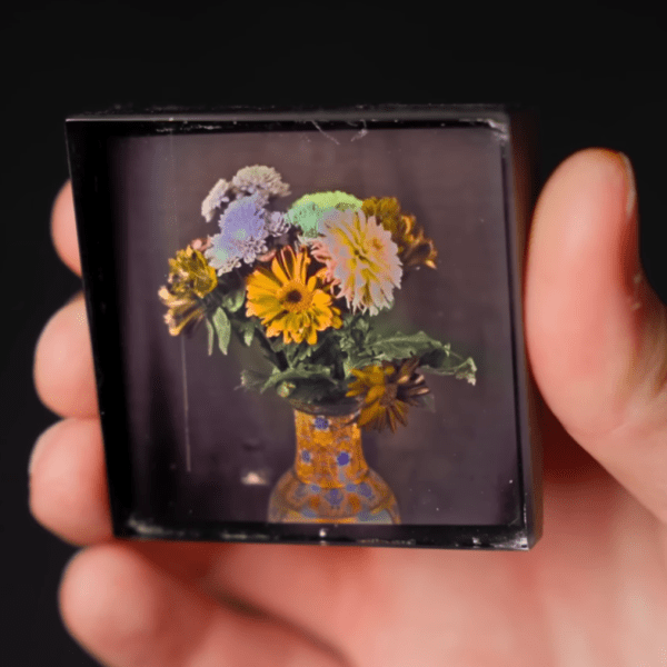

Although modern cameras can, with skill and good conditions, produce photographs nearly indistinguishable from the original scene, this fidelity relies on the limitations of human vision. According to the trichromatic theory, humans perceive light as a mixture of three colors, which can be recorded and represented by cameras, displays, and color printing; a spectrometer, however, can detect a clear distance between the three colors present in a photograph and the wide range of spectra in the original scene. By contrast, one of the earliest color photography methods, Lippmann plates, captured not just true color, but true spectra.
A Lippmann plate, as [Jon Hilty] details, starts with a layer of photographic gel containing extremely fine silver halide crystals over the back of a glass plate. This layer is placed on top of a mirror, traditionally a mercury bath, and put in the camera. When light passes through the emulsion and reflects off the mirror, it interferes with incoming light to create a standing wave. The portions of the emulsion at the wave’s antinodes absorb the most energy, converting local silver halide crystals into reflective silver. The spacing of the silver particles depends on the incoming light’s wavelength, and is fixed in place during the development process.
This creates a matrix of vertically-stacked diffraction gratings, each diffracting back the original wavelength when illuminated with white light. Unlike normal diffraction gratings, the wavelength of diffracted light doesn’t depend strongly on the viewing angle; since the interference structure here is vertically-arranged, it refracts a narrow range of wavelengths across all possible viewing angles. The viewing angles, however, are limited; unlike with dye-based photographs, you can only view the colors nearly straight-on. This, along with the necessity for long exposures, the chance of producing washed-out colors, and the impossibility of creating reprints, kept Lippmann plates from ever really catching on. The basic concept lives on in holograms, which encode spatial information in a similar kind of photographically-formed diffraction pattern.

        I guess the definition of expensive will vary from person to person, but they’re not super bad – probably cheaper than wet plates even when figuring in equipment (which, to be fair, aren’t exactly cheap either).
        Silver nitrate is probably the most expensive chemical that gets regularly consumed. But you only use 1-1.5g per 200mL of emulsion, which gets you a good 50-60 plates if you shoot in tiny 6×6 format like I do.
        The spectral dyes have a large upfront cost, but you use them at 1:1000 dilutions, so 1g of each will last you a solid decade (as long as you don’t drop a bottle and leave one of the most expensive stains of your life on the basement floor like I did).
        You can skimp on the lab equipment and get by with thrift store kitchen supplies, but you’re just shifting monetary cost over to time investment considering all the extra babysitting you need to do to keep the temperatures in range.
        I give it an overall expensiveness rating of “Not great, not terrible”.
        1. Makes sense to me, thanks for the encouragement. I’ll probably get into it in a few weeks once a few paychecks go through. I was reading about how people aren’t using mercury anymore. But is it really as simple as having an air gap instead?
          1. Yeah, you can get by with an air-gap. The one in the video thumbnail was made that way. They tend to come out with cooler tones than metallic-reflection plates, and are way more susceptible to processing-induced shrinkage, so you need to swell the plates with glycerin or citric acid after development. During development, there’s a tradeoff between brightness vs. saturated colors, and I found air-gelatin plates are a bit harder to get just right.
            Last summer I did a lot of work with rubbing reflective mica powder onto the back of moistened plates before exposure, and then cleaning it off with IPA before development. This seemed to work pretty well as a mercury alternative, and overall seemed to give you a much wider “goldilocks zone” during development. Most of the other ones Steve showed off were made this way
          1. I actually have a fairly old video on that!
            https://www.youtube.com/watch?v=d0amad5OZf0
            I will say, though, I was a lot younger and much, much worse at designing/building stuff back then, and I think this is worth a second look.
            The issue with galinstan is the oxide layer that rapidly forms on contact with air. The video largely covers the difficulty in removing it from the plate without damaging the emulsion, but I regret never actually designing a back to fit into the camera and shooting one. I used to have concerns that whatever gallium oxide in contact with the plate wouldn’t produce a good enough reflection either so it would be really “spotty”, but the success with mica seems to indicate you can still get really good results with a fairly imperfect reflection.
            I’ve thought about using EGaIn, which has a bit higher freezing point than galinstan – the thought being that I could shoot the plate with it as a liquid, and then freeze it and pop it off in one chunk.
            I did also try pure gallium, by melting it and pouring it against the plate in a mold, and allowing it to solidify. This actually kind of worked – I got super bright colors, but they were all “wrong” compared to the rest of the scene, and I couldn’t figure out a pattern to explain them. The plate took on a lot of fog too, which may have been from the gallium expanding as it froze.
            The success with mica made me pump the breaks on liquid mirror systems, but before that I was really considering mercury-indium systems. It’s not perfect, but it does cut down significantly on the amount of mercury vapor that gets released. I’m interested in trying it still just to see how it performs, but I don’t plan on ever having mercury be a part of my normal workflow. I imagine in the process of designing such a back for mercury, I’ll be testing it out with galinstan beforehand, so I’ll definitely shoot a few plates with that just to see.
        2. For the liquid metal mirrors, there’s some non-gallium non-mercury alloys, although most of them involve lead. The best non toxic one is Field’s metal, which I’ve made. It seemed as if it was a little less keen to have oxide problems than gallium, but it still had a bit. Maybe the way to go would be to fill the container first with a safe liquid like whichever of water, alcohol, or oil would not interfere, then squirt in the denser metal displacing the original liquid. Would have to all be done hot though, for these types.
          1. That could work. I’ve kind of considered looking into those alloys – I’m not keen on working with the ones with cadmium/lead, so I think Field’s would be the way to go. It’s just a bit too hot to make me worry though – traditional film can take on fog when exposed to heat. 62C should be low enough to get away with, especially for a shorter period of time, but that really is getting close to the upper limit.
            The Lippmann emulsion seems like it is overall, just, less robust than your typical AgX emulsion. I have kind of conflicting results, so I’m not 100% on this, but it seems like they might be sensitive to contact pressure on the plates itself. That reason alone may mean that the heat could cause fog. That being said, I’m wrong more often than I’m right when it comes to these things, so I think it’s undoubtedly worth a shot!
            I’m curious, because I’ve never talked to someone who has worked with it before. If it solidifies against a flat surface, do you think it would be reasonably shiny / mirror-like?
          2. I’d say it’s shiny, yeah. I’ll try and remember to get a picture or video.
          3. Thanks a lot for sharing that – there’s a fair chance that’ll work! I’ll pick some up and try and play around with it!
