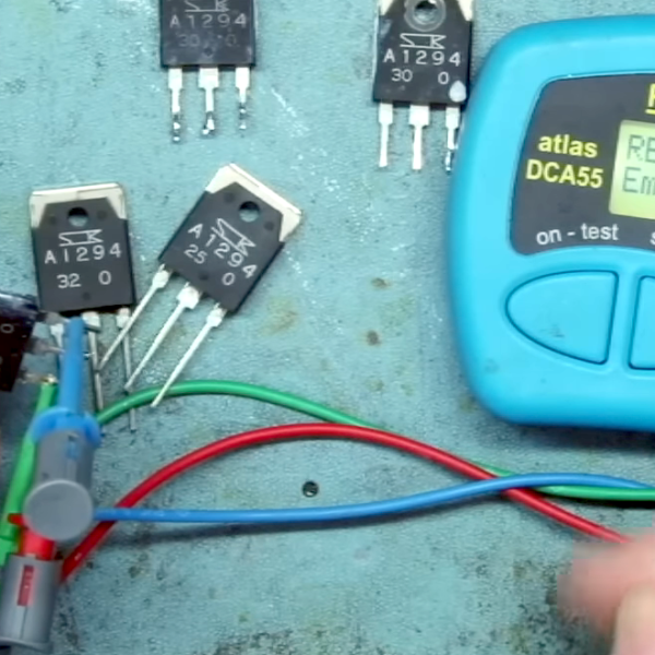

Transistors in some circuit configurations work together and, frequently, need to be matched. This is so common that you can sometimes find ICs that are just a pair of transistors made with the same piece of silicon, so they should be matched very closely by default. But with discrete transistors, two devices of the same type are not always identical. [Learn Electronics Repair] covers the topic and explains how to match devices in the video below.
Depending on the circuit, the matching parameters may be different, but generally, the idea is that you want similar gains or matching saturation characteristics. The reason is that when you have multiple transistors working together, you don’t want one to do more work than the other device. This is inefficient and could drive the “better” component to fail.
The same idea applies in bridge circuits, where you might match resistors or capacitors to make sure that, for example, two 10% resistors are very close to the same value. A 10K resistor could be between 9K and 11K, and you might not care as long as they are both, say, 9.2K or both 10.8K.

  2. A long time ago when I was making Audio Amps with symmetric circuits, simply blew up if I don’t use matching transistor.
  3. There were manufactured matched transistor pairs for both BJTs and JFETs. The structures were matched by machine, and then bonded to the same baseplate and encapsulated together. This kept them at the same temperature during operation. The need for matched pairs decreased as manufacturers moved away from discrete components toward ICs. Rarely there is need for matched pair, and usually it’s for a very specialized circuitry…
    For power transistors in audio amps matching is less important because design should use emitter resistors that will divide currents flowing between transistors equally…
    1. The LM394 ultramatch pair is a single die. In my experience, the main uses are low offset amplifiers and precision analog multipliers. They behave very close to theory, which makes them useful in log and anti-log circuits.

  6. Matching is easier these days because you can buy matches transistors in package. While die to die variations in parameters is huge, on die variations are minimal and can even be tweaked as necessary. It’s simply too easy in a modern process to produce matched pairs on the same die.
    As for handling. BJTs and JFETs are fine. It’s only MOSFETs with their delicate gate oxides that are easily destroyed by static.
    1. With a product that needed matched bipolar transistors, we found that dual transistors in SMT were actually matched as the separate die are being picked off adjacent spots on the wafer and packaged, and also that adjacent single transistors in tape & reel were also matched for the same reason. (There was a temporary supply squeeze on the “proper” matched pairs, hence proving this, but then we never went back to the marginally more expensive matched pairs because cost)
