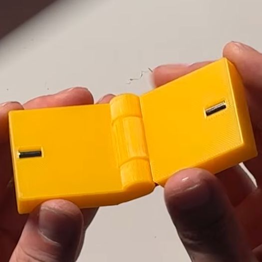

Magnets are awesome, so it’s no wonder we love to add them to our 3D prints. Doing so in a way that will actually last is harder, with thermal creep being one reason a simple friction fit will loosen over time, and using super glue to hold a magnet in place can be messy. In a recent video, [Slant 3D] covers seven ways to install magnets in 3D prints without resorting to glue, along with the advantages and disadvantages of each.
With friction, the argument is that you can still use them, but you’d want to use something like cylindrical magnets rather than flat magnets to increase the friction with the thermoplastic. Using an arbor press rather than human primate hand power is also beneficial.
Rather than installing magnets halfway through a print with all the logistics that entails, you can use side slots to install said magnet into, which is much easier, but as with all embedded magnets, you get that plastic barrier between the magnet and its target.
Other methods involve using a bit of extra material that you need to push the magnet past, using something like an arbor press, so the magnets should never just fall out. A wildcard here: spherical magnets, which can be locked in using a similar method, while automatically orienting themselves to an opposing magnet.

  2. Maybe I missed it, I was watching at high speed… But if I caught this right, cylinders and spheres both can be pressed in well. And spherical magnets cost more. But cylindrical ones you have to make sure to align north to south (with two magnets).
    Ok.
    Why not mix and match?
    Use a cylindrical magnet on one side with a ball bearing on the other?
    You get the easy, press fit construction.
    You only buy one, less expensive cylindrical magnet.
    And you don’t have to worry about lining up the poles right.

  6. Metal + one large magnet takes up more room and is less cost effective than just using two magnets that are half as strong.
    If using the “cylindrical retention clips” at 5:30, do not purchase magnets with an “axial” magnetization orientation. Instead purchase magnets with a “diametric” orientation. They will hold stronger and self-orient every time. Other than aesthetics, there is ZERO reason for spherical magnets. It is a more expensive and weaker option with no upside.
