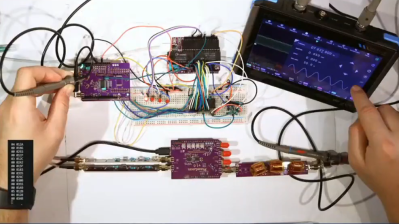

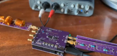

Early testing just relied on using a soundcard as an ADC to verify things were working.
The ultimate goal was to build an affordable SDR with a bandwidth up to 20 MHz. To reach this in his build, [Anders] picked a TLV3253 to serve in the quadrature sampling role, for its quick switching speed and low on resistance. It’s paired with a Silicon Labs 5351 which serves as the local oscillator. It’s possible to phase offset two clocks from the same phased-locked loop, allowing the generation of multiple clocks of the same frequency but offset by 90 degrees. An ADA4891 op-amp is used as a buffer between the capacitors of the quadrature sampling detector and the analog-to-digital converter itself. Testing began with a very simple ADC—a soundcard, capable of up to 44.1 KHz of bandwidth. Later, [Anders] stepped up to using an STM32 with a dual ADC for 200 KHz bandwidth. Eventually, though, the build was upgraded to the HT9201 dual 20 MHz 10-bit ADC. Getting the signal into the computer is handled with an FX2LP clone, which can stream data over USB 2.0 at high speed. With a nominal 480 megabits on offer, the choice is to run with 20 MHz of bandwidth at 8-bit samples, or 10 MHz of bandwidth with 10-bit samples.

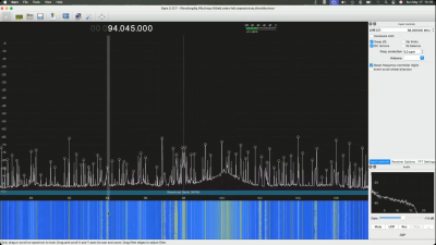

The live demo showed the SDR pulling in the whole FM broadcast spectrum at once—a neat way to put the rig through its paces.
There were some challenges that cropped up along the way. Getting a flat analog frequency response proved difficult, with [Anders] noting this requires good attention to PCB layout, as well as things like amplification and filtering. There were also difficulties with clock jitter and synchronization, and bandwidth limitations in the front end. However, none of this stopped [Anders] from giving a live demo of the SDR in action during the talk. He showed off his rig pulling in the whole FM broadcast band, all at once. The crunchy sound of a commercial station coming in live was an excellent way to show that the SDR indeed was functioning as intended. [Anders] also used this as an opportunity to show some tricks to identifying and dealing with mirror signals when they pop up. There’s plenty that [Anders] wants to do with this project going forward, too. He notes that a wideband front-end mixer is on the cards, as well as a low-noise amplifier and an improved filtering strategy, all of which should improve flexibility and performance.
