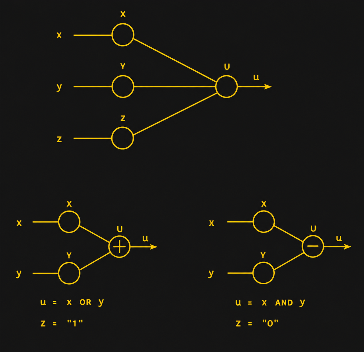

To make a logic gate, several preceding parametrons are weakly coupled into the next one. When that next stage is excited, the incoming signals provide a tiny initial oscillation. Because the parametron behaves rather like a regenerative amplifier, that initial signal rapidly grows into a full-amplitude oscillation. With three inputs, signals having one phase reinforce each other while opposite-phase signals cancel, so the new parametron naturally settles into the phase held by the majority of its inputs. Thus a three-input parametron is inherently a majority gate.
Ordinary Logic
Tie one input permanently to 0 or 1, and the same circuit becomes AND or OR; reverse the polarity of a coupling transformer and you get inversion. You can see this in the graphic from the original paper. In practical machines, groups of parametrons were driven by staggered clock phases so the result of one stage was established before the next stage was allowed to oscillate.

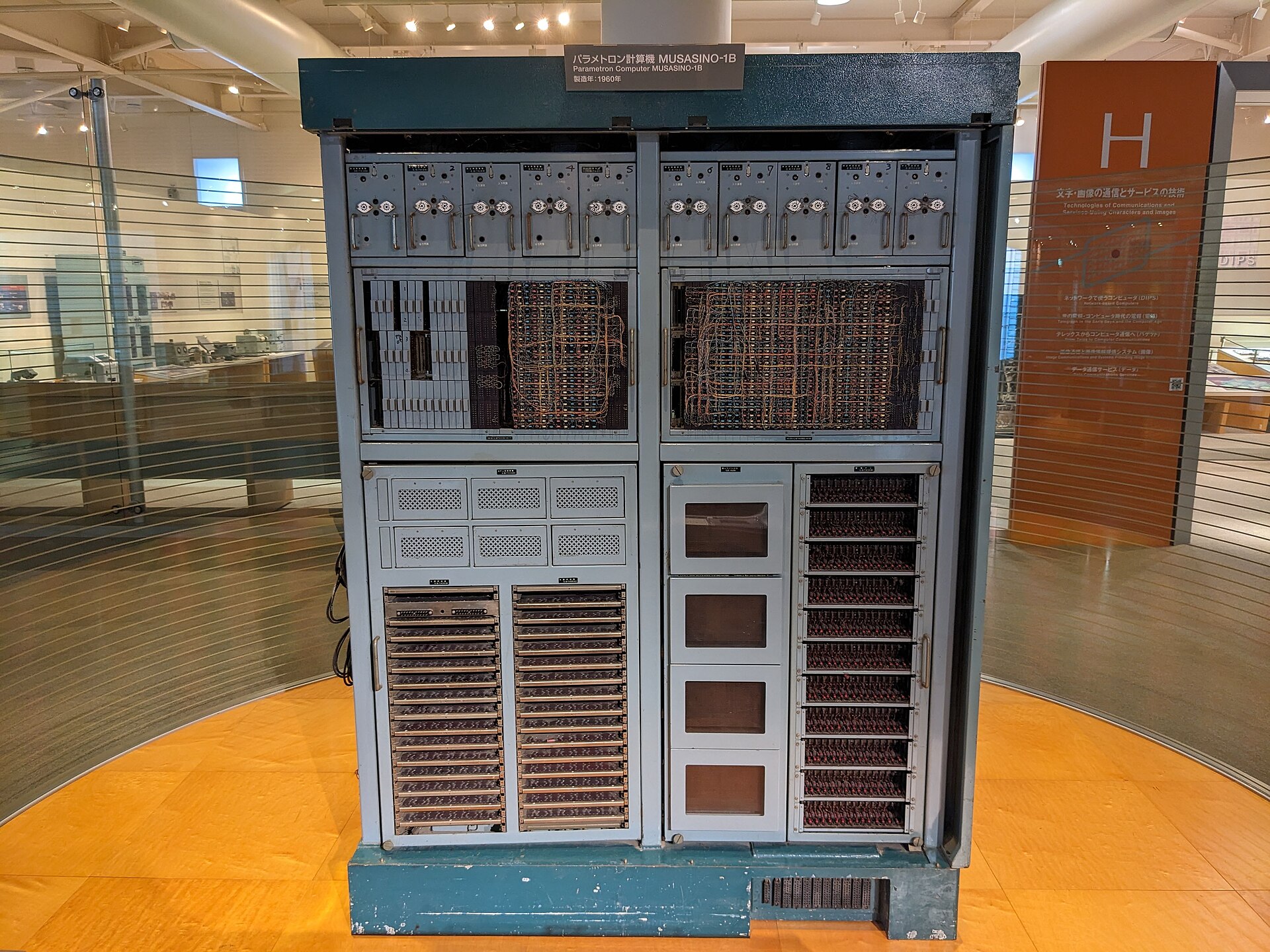

The largest of these computers had 1,024 words of core memory. What’s more, parametrons could drive magnetic cores differently than conventional core memory. One advantage is that, unlike conventional core memory systems, reading these cores did not erase them.

Featured image: Fujitsu FACOM 201 Parametron Computer by [Daderot].
