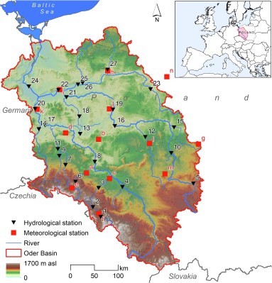

Locations of the 27 hydrological stations and the corresponding meteorological stations in the Oder river basin. (Credit: Jiang Sun et al., Geoscience Frontiers, 2024)
The cheapest option of all is of course to use once-through cooling from a nearby body of water. This can be a local lake, river or reservoir. The obvious disadvantages here are that you have little control over what debris and contaminants may want to slip in along with the water, nor do you get to control what temperature the water is going to be at the intake. Fortunately you can filter out wild life for the most part using systems like screens that physically block entry.
Between the 1950s and 1990s when there were a lot of new thermal power stations being constructed, there was no real problem when it came to river temperatures, with generally high river flows and especially in Europe relatively mild summers. Yet if we look for example at historical discharge flow for the Danube river, as well as the water level time series for 2008 – 2026 measured at a single location, we can see that the past few decades there are fewer wet periods, more dry periods and overall the water level drops more often to lower levels.
Perhaps unsurprisingly, water temperature is directly correlated with air temperature, with recent studies such as a 2024 research paper by Jiang Sun et al. showing a clear warming trend, as demonstrated for central Europe’s Oder (Odra) river basin. The warming rate differs per location, varying from 0.229°C to 0.720°C per decade, creating a slight but ultimately noticeable difference that in other locations that experience even more severe heatwaves like Spain or France will be more pronounced for its river systems.

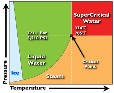

The critical point of water and its supercritical state. (Credit: Jonathan Kamler, Wikimedia)
An interesting question that one may ask here before getting into the gritty details of power station plumbing, is why it seems that it are basically always nuclear power stations that appear to be affected by rising temperatures, rather than other types of thermal power stations. The short answer is ‘light water reactors are pretty terrible’, with the longer answer entailing a detailed explanation on the Rankine cycle, thermal efficiency and why even a pressurized water reactor (PWR) version of a light water reactor (LWR) runs at an abysmally low core temperature that results in a lot of waste heat having to be dissipated.
We can see the effect of this with the efficiency numbers of e.g. a typical modern LWR like the VVER-1200, which is about 35% despite being already a PWR with correspondingly higher efficiency than a boiling water reactor (BWR) that operates at atmospheric pressures. The older VVER-440 design – of which four units have been operating since 1982 at the Paks Nuclear Power Plant in Hungary – has an even lower efficiency of just below 30%.
Ideally, what you want is a supercritical or even ultra-supercritical pressure and temperature for optimal efficiency. This realization is what has pushed the thermal efficiency of coal plants up by increasing the temperatures and pressures of the steam that reaches the steam turbine. With the average LWR running in the subcritical regime, their thermal efficiency is fairly low and thus the waste heat (Qout) is relatively high, almost all of which ends up being dumped into the condenser.

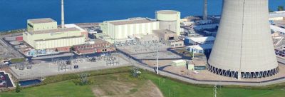

Units 1 and 2 of the Nine Mile Point Clean Energy Center in NY. (Credit: Constellation Energy)
The upshot of all of this is that back in 1979 nobody was batting an eye at the idea of using once-through cooling using river water for a nuclear power station, because nobody figured that we’d be having this much climate change within its project lifespan. This thus leaves those of us in 2026 with the question of what the options are to fix this temporal oversight.
The good news here is that it only concerns some plumbing and the construction of some additional structures. The bad news is that it’s a pretty extensive retrofit that so far has seen little uptake, even if there are historical examples. One is the twin General Electric BWR unit Nine Mile Point Clean Energy Center (NMP) in New York, whose Unit 1 features once-through cooling from Lake Ontario, while Unit 2 uses a natural draft cooling tower (NDCT).

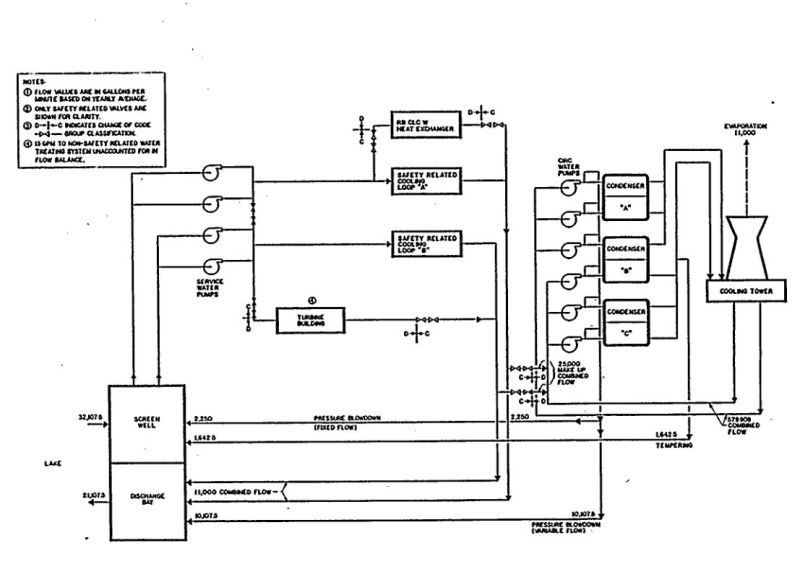

Interestingly, originally both units were intended to draw their cooling water from Lake Ontario, but in February 1976 the Nuclear Regulatory Commission (NRC) received a request to change the cooling system for the then under construction Unit 2 to be changed to use said NDCT. The NRC environmental and technical report for this change can be found as a scanned-in PDF of the original document.
Flow diagram for Unit 2 of the Nine Mile Point power station. (Credit: NRC)
The main changes are probably the increase in system complexity, the size of the NDCT and the impact of the water vapor from said NDCT, none of which posed an issue at the time per the report. At the time of the report’s publication, construction of Unit 2 was already more than 37% complete with approval for this change pending during the intervening years.
The station owner indicated that building the cooling tower would take 32 months, which presumably would also include all the piping and related components.

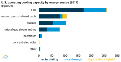

Spray ponds are another, more low-tech option that also happens to be low-profile, while dry cooling is slowly becoming an option. These either use essentially big radiators, or capture the cooling water for the condensers again to create a closed system, with no water lost to evaporation.
US Operating cooling capacity by energy source. (Source: EIA)
(Source: EIA)
Obviously not losing any water at all would be ideal if the restricting factor is a lack of water. This is the case especially in water-restricted environments, such as desert environments and heatwave-stricken continents with drying-up rivers.
