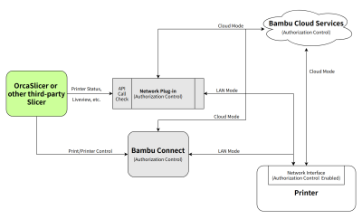

With this I can just pop open an interface in a browser tab and manage the printer, watch the webcam view, etc. from there. Somehow there’s now a third option that seems to be taking over, however. Although a web interface seems straightforward and easy for the average user, there’s been this move towards requiring the use of the slicer via a special API or such that leads to fun access situations as we have recently seen with Bambu Lab printers.
The remote printing future according to Bambu Lab. (Credit: Bambu Lab)

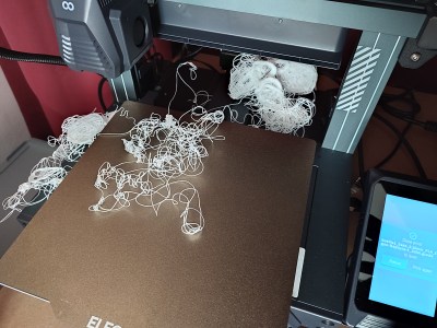

For this first printing round, I printed the same parts on the Neptune 4 in white PLA and black PLA. For the GK3 Ultra I just used the ABS-like (AL) clear-blue resin, to not have to switch resins just yet. The prints include a range of items like bottles, some figurines and a bunch of LEGO Technic-compatible parts. The latter two serve to give dimensional accuracy a good workout, along with basic durability testing.
Everybody loves FDM spaghetti. (Credit: Maya Posch)
Starting with FDM printing, this was largely uneventful, though I upped the difficulty challenge with the N4 by using a spool of extra-brittle white PLA. Somehow even that came out fine, aside from an unfortunate spaghetti incident that required some PVA glue to be slathered onto the PEI build plate.

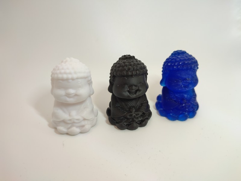

Since both Elegoo FDM printers come with an example model in the form of this happy Buddha figurine, I figured that I’d also print it with the GK3 Ultra. Here you can see how these compare in a sloppy smartphone photo for which I apologize:
Three happy Buddhas. (Credit: Maya Posch)
The model was clearly intended to be printed on FDM printers, so the SLA version doesn’t really add a lot, other than a lot of weight. Unlike FDM prints where you have aspects like ‘infill’, an SLA printer can print everything 100% solid with zero time penalty. In fact you want to do this so that you don’t need to drill a hole in it for liquid resin to leak out.

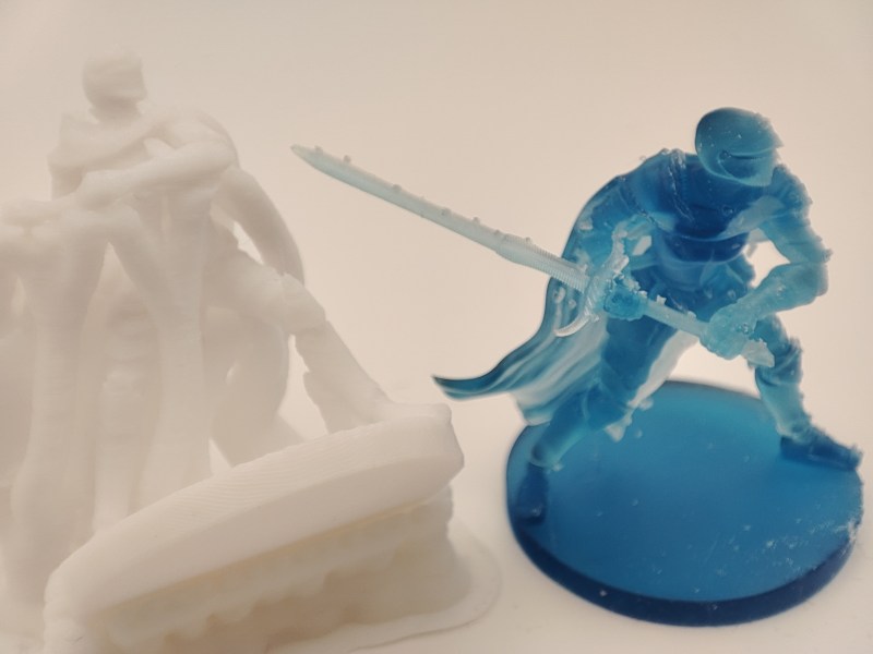

Moving on, I also printed a miniature knight figurine on the N4 and GK3 Ultra, which was a bold decision for the former:
FDM figurine vs SLA figurine. (Credit: Maya Posch)
Removing supports on this approximately 32 mm tall model was a bit of a nightmare with the SLA version, and I still need to clean it up better, while also rethinking ChitBox’s insistence on angling it upside-down for some reason.
I didn’t even bother with removing supports on the FDM version, although I was somewhat surprised at how much detail it still had when pushing layer height to its ‘super fine’ 0.12 mm setting, though the SLA printer with the ‘sloppy’ 0.1 mm layer height preset is simply in another universe when it comes to preserving fine details.
Clearly layer heights between SLA and FDM are at best the fuzziest of all overlaps, with even the knight’s cape in the SLA version capturing the flow of the fabric and details in the helmet that the FDM version had obliterated.

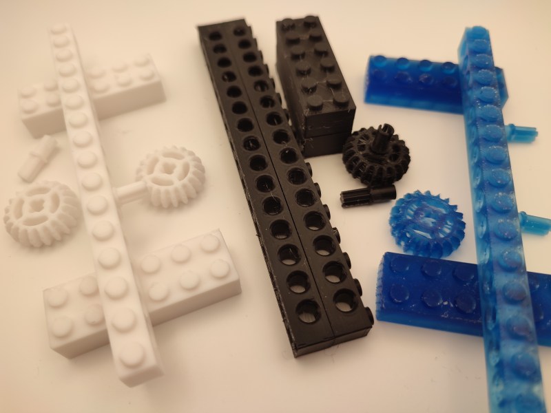

Finally there are the LEGO Technic-compatible shenanigans:
Merely LEGO Technic-compatible, please don't sue. (Credit: Maya Posch)
Merely LEGO Technic-compatible, please don’t sue. (Credit: Maya Posch)

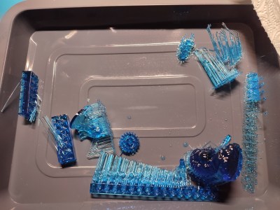

There is obviously a lot of variability and improvement possible simply by the orientation you print things in, the type and placement of supports. SLA has the massive advantage here that support points on models can be made absolutely tiny and correspondingly leave almost no mark. This made e.g. printing LEGO-compatible parts a snap on SLA, but a nightmare on FDM where I struggled to find an orientation and support/brim configuration that didn’t lead to misprints and/or interfered with the part’s functionality.
The thing where ChituBox really did me dirty, however, was that it went crazy on supports, even adding lots of supports inside these latter parts that still have to be painstakingly poked out if I want to actually properly use them. This is however a slicer issue and potentially a skill issue on the side of yours truly.

On the SLA side of things there wasn’t too much to upset me, other than some table-flipping at the automatic resin feeding system which I mentioned in the first article. After starting the print, the system seemed to work and began filling the vat with resin, albeit very slowly. At some point I got a ‘material in/out time-out’ error, following which I retried printing, with the resin system again trying to fill the vat for a long period of time.
Ultimately I decided that since I only needed just over 60 mL for the print, and it had already poured in about half the resin bottle, I’d just cancel it. It’s likely that I missed a step here, such as I’m not sure whether you need to pop open the bottle for this to work, but the manual did not mention such details.
Popping over into settings I disabled this auto-feed system and tried to printing again, which worked without issues, other than the backstabbing by ChituBox and a persistent resin smell. This latter issue I tracked down to the slot for the resin bottle, which may or may not be related to the auto-feed issues. After sealing up the gaps the resin smell faded quickly, making it seem at least plausible that the active-carbon system of the machine does something.
After printing I did the usual post-processing, just with a scraper to knock the supports loose instead of something more gentle with a flex plate. The parts were tossed into IPA for a quick clean, including a trip through the ultrasonic cleaner. This was followed by another quick IPA rinse and finally some tanning with a UV lamp in a water bath. This latter step is to keep oxygen away from the curing process and thus speed up the curing, which is one of those details that have worked well for me in the past.
