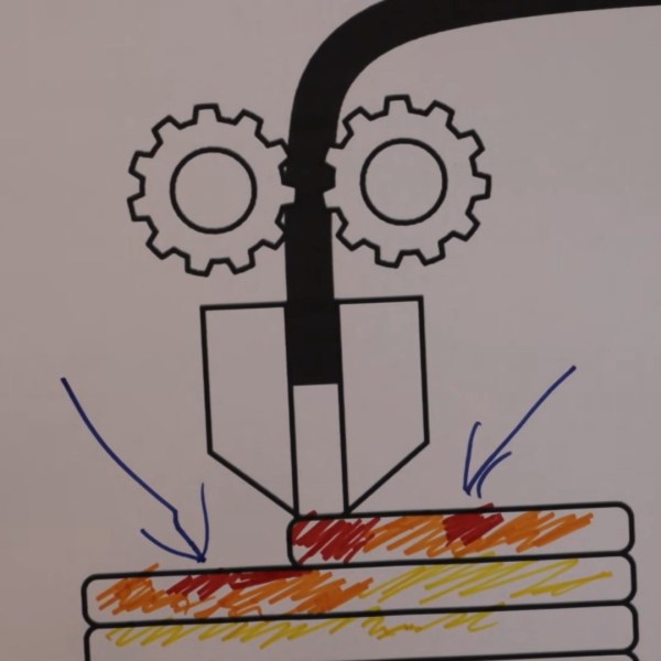

If there’s one defining factor about 3D printing you have to account for when you’re making a design, it’s probably layer adhesion. Sure, there are a lot of factors to consider, but having the z-axis of your part dramatically weaker than x- and y- is a pretty big deal in a whole lot of applications. [I Changed a thing] changed a thing to fix that — namely, he changed his 3D printer by strapping a couple of lasers to it. That’s the kind of hack we like to see!
What the lasers are doing is a very simple idea: they’re pre-melting the last-laid-down-layer just under the nozzle so that molten plastic is meeting molten plastic to create a much stronger joint than you get when you extrude onto an already-cold layer. The second layer keeps the hotspot warmer longer, which also helps the bond. The resulting parts are not purely isotropic, but he’s getting breaking strain along the z-axis of ABS that’s up to 94% of what he’s measuring in the x direction, while PLA still rates at 77.9%. That’s compared to 60% and 41%, for un-lasered samples, respectively. If you watch the video, you’ll get all the details for the printing process and can see more test data.
These lasers look like a game-changer, but their mass might slow down the fast coreXY printers that are so popular these days. If you don’t want to slow down, remember that changing your layer patterns can boost a print’s strength on its own.

  1. I would like to see a test of these strengths vs. just using a heated chamber.
    If there are lasers like this the machine will need to be fully enclosed (and likely ventilated). So if the enclosure is required anyways…might as well verify if you even need the lasers.
    When I tested enclosures I was planning to have heaters/fans for the chamber temp but I realized pretty quickly that the heated bed gets the chamber to temp very quickly. It becomes an issue of needing to remove heat instead of adding it (at least in my tests).
    Aside from that…the idea of heating the layer with a laser (or hotair) has been kicked around quite a bit in the reprap community for years…good to see someone getting around to testing it.
    1. Gonna need to be a pretty hot heated chamber if it causes everything inside to glass transition. Also you don’t want the entire print to glass transition, it’ll become all rubbery and warp-y. You just want the area where molten PLA is about to go down to be in that state.
      1. It doesn’t really need to do that – just keep everything hot enough that the newly laid down filament is now hot enough with enough thermal mass to remelt the still warm of the previous layers more for closer to isotropic plastic. (maybe even very warm with a fast printer and warm air the previous layer can still be too hot to print on without setting minimum layer times)
    2. if the laser is properly scaled it would cause no more fume issue than the hotend. You dont want the laser to vaporize material, just warm it to the glass transition temperature.
    3. a standard heated build chamber alone does improve layer adhesion significantly, but really just for plastics like ABS that have a high softening temperature, not for things like PLA. CNC Kitchen has a blog post with quantified measurements from a few years ago, and there are also a few scientific papers you can find demonstrating a huge improvement for specific materials like PEEK.
      Compared to CNC kitchen’s result, this laser technique appears to be much more effective than a heated chamber for both ABS and PLA.
      One caveat is that the hobbyist heated chambers aren’t actually run that hot, so it’s possible that the strength improvement for ABS is just from higher temperatures rather than technique. But the same can’t be said for PLA.
      And running a hotter chamber has its own problems – the closer you get your heated chamber to the softening or glass transition temperature of your plastic, the harder it will be to avoid sagging, dimensional instability, and other print issues.

  4. This is not the way to do it, adding all that mass, better to have a fiber laser and bring the light to the target area via optical fiber/s traveling along the same path as the filament feed.
  5. If you must slow down printing speed dramaticly because you’re hanging two heavy laser modules on you printing carriage you might as well just at the slow speed and raise your nozzle temperature a bit so the new layers melts the previous layer.
    Same result and cheaper
    1. The laser shouldn’t be attached to the extruder, just use a glass fibre near the nozzle. Advantage of the laser is that the locality of the heating is more accurate, increasing the nozzle heat melts everything in a relatively large radius.
