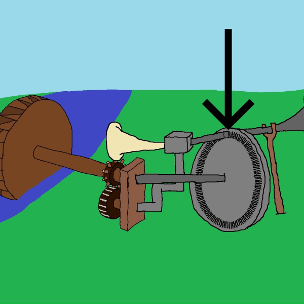

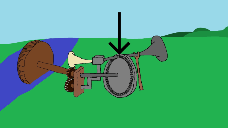

[The Mike Stuff] has an interesting proposition. He asserts that ancient people like the Greeks could have built a form of radio that was purely mechanical. We aren’t sure we agree, but even if it were possible, we are sure it would have sounded awful. You can see the details in the video below.
The idea is that you can compress air with a waterwheel, blow it through a rotating disk with slots in it, and a valve to amplitude modulate the airflow through the disk. Horns like an old gramophone speaker would amplify the signal at both ends. The demodulation is straightforward and doesn’t even require power, like compressed air.
This is a fun idea, but even [Mike] notes it wouldn’t be very good. We suspect you’d just hear a 10 kHz buzz. On the other hand, this would be pretty easy to build if you wanted to test it. Use an electric motor to spin the disk — after all, we’ll stipulate that you could turn a disk with water power, even if speed control is a little challenging.
If you build it, we’d love to hear about it. Just don’t use it to send us an air-radio message. Try e-mail instead. What do you think? Would this work? We get that if it did, it wouldn’t work well, but would it work at all? Let us know what you think.

The same reasoning that applies to radio applies to this “acoustic transmitter” as well:
You can use different carrier wave frequencies to transmit multiple signals through the same medium and pick out just the one you want to hear.
It is easier to build an amplifier for a narrow bandwidth signal. You don’t gain as much advantage using a carrier frequency of 10kHz for the acoustic transmitter as you do with a radio transmitter (AM band 540kHz and above,) but you do get some.
It is easier to build resonant circuits for more efficient transmission and reception with a narrower bandwidth. Again, you don’t gain as much asvantage with a low carrier frequency as you would at higher frequencies.
The carrier makes it easier to pick the transmitted signal out of the noise.
The biggest down side is that you don’t gain as much advantage from the acoustic carrier as you do from a radio frequency carrier. The signal bandwidth is simply too close to the carrier frequency
The other thing is that normal people can hear a 10kHz audio carrier. It is going to be really loud and annoying
