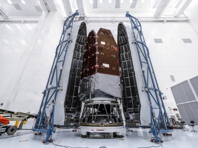

The Nancy Grace Roman Space Telescope being installed within the payload fairing ahead of mating to a SpaceX Falcon Heavy rocket. The spacecraft came in over 1,700kg under its initial planned weight budget, both easing fuel needs for the mission and leaving plenty of headroom for NASA to brim the tanks. Credit: NASA
