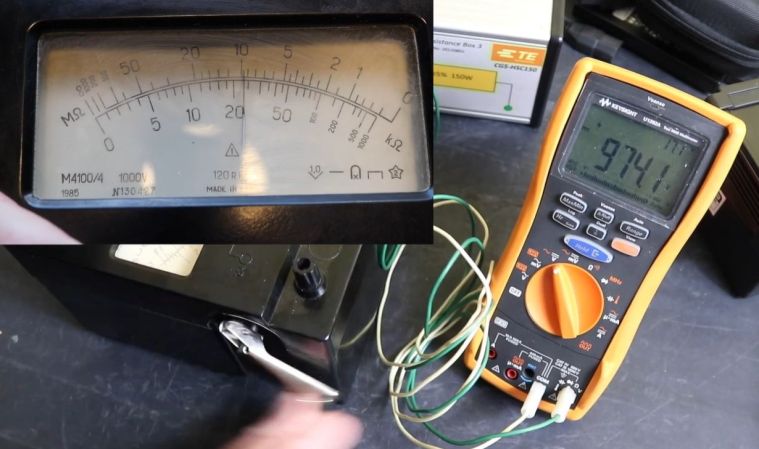

This particular unit dates to 1985, and comes in a rather nice-looking case that somewhat looks like bakelite. It’s rated for up to 1 gigaohm, putting out 1,000 V by using the crank handle. Because of the pristine condition of the entire unit, including seals, it was decided to not look at the internals but only test its functionality.
After running through the basic usage of the insulation tester it’s hooked up to a range of testing devices, which shows that it seems to be mostly still in working condition. The first issue noticed was that the crank handle-based generator was a bit tired, so that it never quite hit the maximum voltage.
With no parallax correction and no known last calibration date, it still measured to about 10% of the actual value in some tests initially, but in later tests it was significantly off from the expected value. At this point the device was suspected of being faulty, but it defied being easily opened, so any repair will have to be put off for now. That said, it being in such good condition raises the prospect of it being an easy repair, hopefully in an upcoming video.
