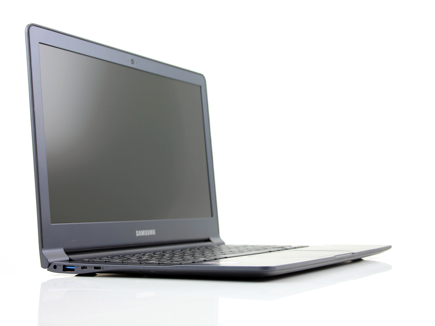

  4. I’ve been using a Chromebook C710 with custom Coreboot and various Linux distros for a few years now as my personal travel machine. Because it’s Intel Sandy Bridge based, it has a few binary blobs that are required (ME and memory init) so it’s not totally open, and of course it’s not OSHW. But being able to fix and build my own BIOS is great, and I’ve even contributed a fix for an ACPI suspend bug back to Coreboot.
    If you can live without OSHW, there are Chromebooks that are even closer to open. The venerable Samsung Series 3 Chromebook has everything buildable from scratch, including U-Boot and the EC. The only exception is the ARM Mali graphics.
