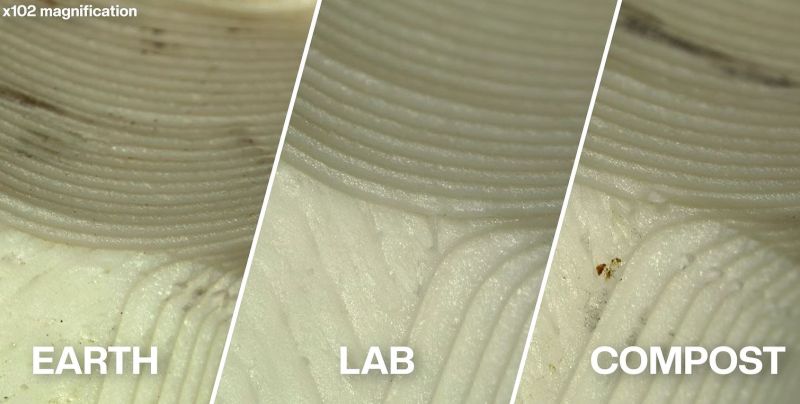

After burying said PLA in the garden like any self-respecting person does who tries to dispose of some evidence, the PLA suffered through a European winter and very hot, dry summer, before being dug up again recently for inspection and testing. Although not the first time that someone has tested this, it’s a good reminder considering just how much PLA filament is used each year.

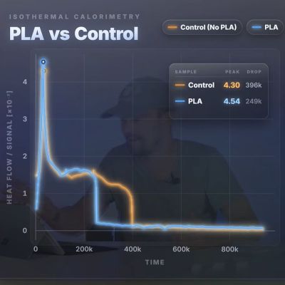

In total three sample sets were used, one being the control, the other two buried in soil and compost respectively. A visual inspection showed no major difference, and a tensile strength test also showed no statistically significant change among all three sample sets. The experiment could have been concluded here, but instead calorimetry was used in a laboratory setting to see whether exposure to microbes as commonly found in soil does anything significant.
This isothermal microcalorimetry test was performed at the University of Basel, effectively to answer the question whether there’s anything in the PLA samples that can feed said microbes. As it turns out, the answer is a resounding ‘no’, with microbial activity within the presence of PLA dropping off even quicker presumably due to there being less volume available for nutrients.
