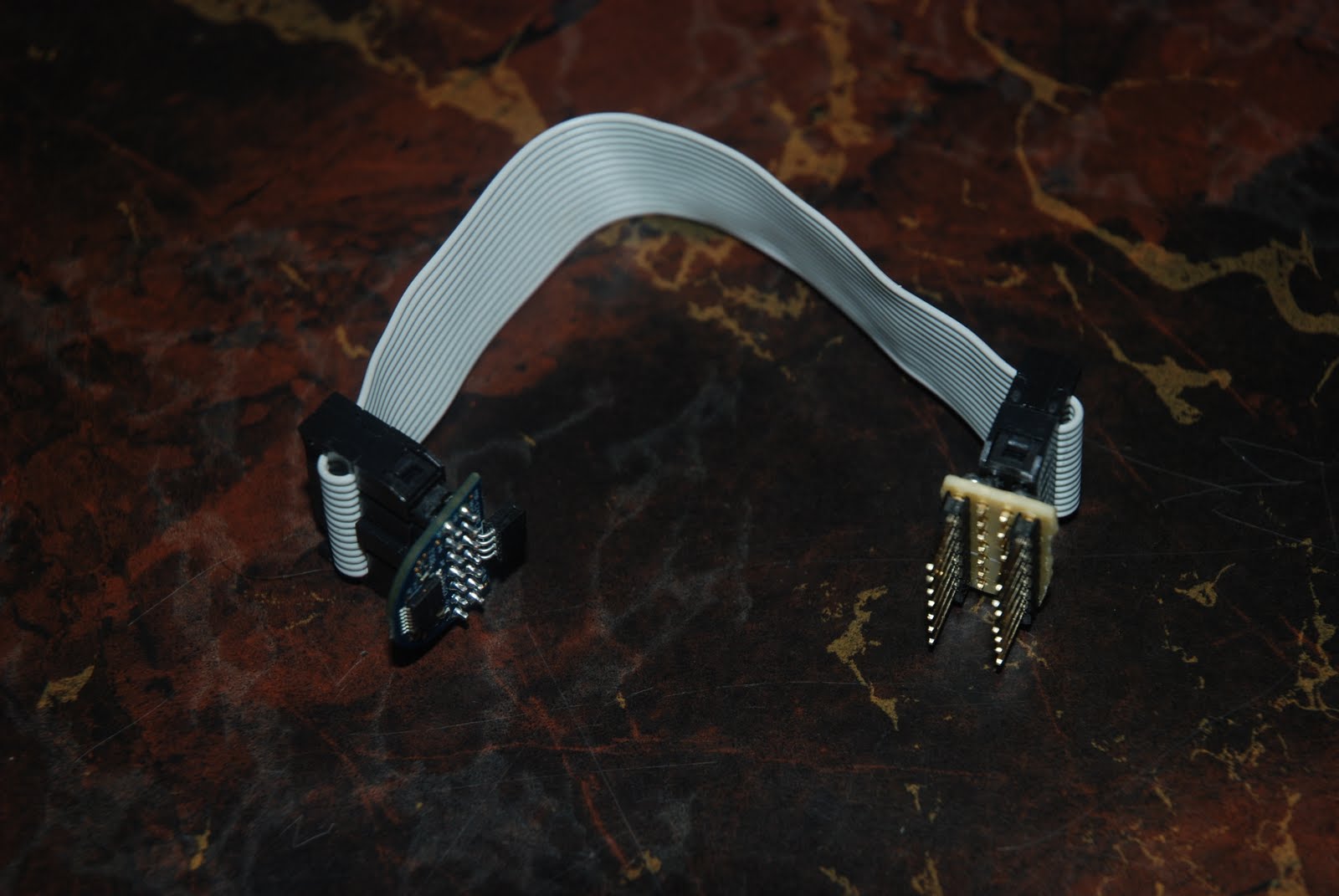

duckbill pliers… 2 wire-wrap chip sockets… bend one of the sockets to match up with the ribbon header, stick short pins in one of the sockets and use that to plug into the other… use a zip tie to hold the 2 sockets together… plug into breadboard.
crappy cell phone pics of this old kludge…
http://c1.ac-images.myspacecdn.com/images02/149/l_0defc367ecf24f6ea3603ca0f2e5a708.jpg
http://c4.ac-images.myspacecdn.com/images02/128/l_4896834ee0984b3fa890f18ef3c09bb7.jpg
