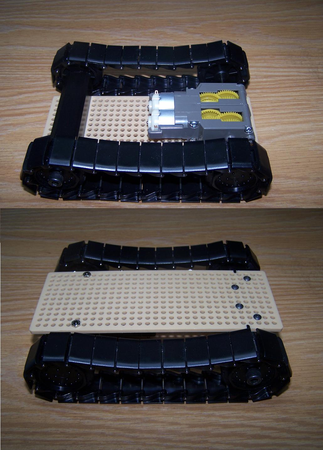

Oh MAN!!! This is exactly what I was looking for.
For use with this chassis : http://www.n2dvm.com/images/Chassis-1.jpg
Platform and Gearbox are Tamiya and the Tracks and wheels came from http://www.pololu.com/catalog/category/24
Made the front “Axel” at work from a block of Delron.
