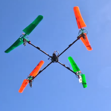

Quadcopters tend to have very poor efficency because of their high disk loading. High disk loading– that is, how much weight each square meter of area swept by the propellers must carry–is almost unavoidable with conventinal quadcopters, which are controlled by throttling the four props. Make the propellers too big, and their inertia slows down that control loop, leading to stability problems. [rctestflight] had an idea to solve this, by borrowing a technology from the world of fixed-wing aviation: variable-pitch propellers.
In aircraft use, they are not new, dating back to the end of the first world war. They’re made for everything from the largest turboprops to the  75 kW(100 HP) Rotax 912. By varying the propeller pitch, you can keep the engine turning in its ideal RPM range but still vary thrust by taking a larger or shallower ‘bite’ out of the air with each sweep of the prop. You can probably see how this applies to the quadcopter: a well-designed pitch-change mechanism is going to be much quicker than throttling a big prop with lots of rotational inertia. That’s the theory.
To test it, [rctestflight] builds some large 3D-printed variable pitch props, hooks them up to regular drone motors via a belt drive, before going on–you guessed it–an RC test flight. To make that work, he’s got the pitch servo being driven from what should be the flight controller’s thrust output to each motor. Aside from the vibrations from imperfect balance on the 3D-printed props, it flies quite well– and much better with pitch control than trying to vary the RPMs of those heavy props. He’s even able to reverse the propeller pitch, making this perhaps the first quadcopter capable of autorotation. Well, almost, given that it lost control and came apart when he cut the throttle.
As for efficiency, it is exactly what you’d expect from this disk loading– so, higher than a conventional quad–even with losses from the belt drive and the high-friction surface of a 3D print. Speaking of 3D-prints, the props did hold up to the maximum RPMs he could throw at them, so no ‘kaboom’ in this video. There is a fun rotary subwoofer bonus at the end, though.
Overall, [rctestflight] thinks his variable-pitch quadcopter proves the concept, but that if you’re going to all this effort you may as well build a helicopter and have fewer points of failure. We kind of have to agree. That is how it worked out historically, after all.

  4. Reminds me of the Stingray 500 from 2013. It was a single motor quad that used a belt drive for all four rotors and variable pitch for control. It let pilots play with endurance numbers a bit because they could set an upper limit on the RPMs and just play with pitch for normal flight.
    Its nimble enough aerobatics and fast enough for racing… and I never heard anything after it initially debuted. Always wanted to see if it could be scaled up to see if I could make a manned version.
    https://www.youtube.com/watch?v=TnGhEInTXYc
    1. I have one. It mostly flew as advertised, and was almost as aerobatic as single-rotor RC helicopters. The biggest drawback was that yaw control was rather weak.
      Fun fact: the rotors are just repurposed tail-rotor mechanisms from conventional RC helicopters.
      1. I expected that repurposing after looking over a friend’s then contemporary helicopter, but never actually knew, makes sense now just as then.
    2. I had an attempt at this concept around that time. I was inspired by the Stingray. My relatively low budget caused some fundamental design flaws but I did manage to get it off the ground.
      I used knockoff Trex250 helicopter tails with directly attached brushless motors. The cheapo motors and ESCs didn’t run well at low speeds. Too much pitch would bog down the motors and mess with the PIDs.
      I concluded that a single-motor synchronised drivetrain would be much more stable.
