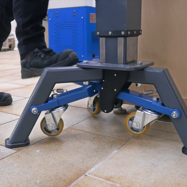

A booted foot is seen descending on a foot pedal attached to a lever underneath a three-legged stand. Three levers extend from the legs, each with a wheel on it, and attach to the central foot plate.
Old shop tools have a reputation for resilience and sturdiness, and though some of this is due to survivorship bias, some of it certainly comes down to an abundance of cast iron. The vise which [Marius Hornberger] recently restored is no exception, which made a good stand indispensable; it needed to be mobile for use throughout the shop, yet stay firmly in place under significant force. To do this, he built a stand with a pen-like locking mechanism to deploy and retract some caster wheels.
Most of the video goes over the construction of the rest of the stand, which is interesting in itself; the stand has an adjustable height, which required [Marius] to construct two interlocking center columns with a threaded adjustment mechanism. The three legs of the stand were welded out of square tubing, and the wheels are mounted on levers attached to the inside of the legs. One of the levers is longer and has a foot pedal that can be pressed down to extend all the casters and lock them in place. A second press on the pedal unlocks the levers, which are pulled up by springs. The locking mechanism is based on a cam that blocks or allows motion depending on its rotation; each press down rotates it a bit. This mechanism, like most parts of the stand, was laser-cut and laser-welded (if you want to skip ahead to its construction, it begins at about 29:00).
Unlike locking caster wheels, this provides significant grip when the wheels are retracted; considering the heft of the vise [Marius] restored, this must be helpful. If you’re more interested in building a vise than a stand, we’ve seen that too.

  3. Bennington already make the “Smart Caster”, which has the same pen-like click-in-click-out mechanism, but entirely self-contained within the caster body.
  4. A very similar mechanism is in a lot of youtube video’s about movable workbenches. I really like the idea of making the wheels retractable (like airplane gear) instead of putting the whole thing on wheels and then attempting to block the wheels for when you want it to be stationary.
    But for a vise… yes, this works quite good as long as you don’t need to put too much pressure on your work pieces, such as holding things while working with an angle grinder or welding. If you need more stability, then I thought of putting the vice on a big (double) sheet of plywood with a few claw nuts and bolts. It’s a bit more work to setup (but much easier to make) and when you are also standing on the sheet of plywood, then it won’t move when you’re putting pressure on the vise. The sheet can have some hinges so you can double or even quadruple it up when it’s not in use. Then put the vise in the center, so it holds the pieces flat.
