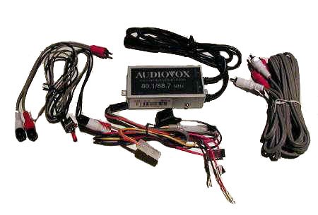

Sounds like most of you never bought a REAL fm transmitter.
http://www.amazon.com/Audiovox-FM100A-Modulator-Isolation-Transformer/dp/B0001KO7UI
Works perfectly every time and NEVER has reception problems….

I for one am glad fartface is here. I agree that it is far better to buy a nearly $50 FM transmitter that needs to be wired up and hidden somewhere in the dash. I mean why buy a $1 jack and wire up an aux jack yourself? That is just plain dumb!
@fartface
FYI that’s not really an FM transmitter, that’s a wired FM modulator and it would require nearly as much as work as this hack, plus it would cost a ton more. And even after all that money you’re still just listening to FM so your sound quality is not nearly as good as plugging directly in like this hack. Besides, you’re pretty lazy if you would rather spend $50 on a $0.05 fix.
