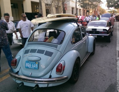

Vintage Beetles also make excellent show cars and beach buggies. Photo courtesy of Bryan Cockfield

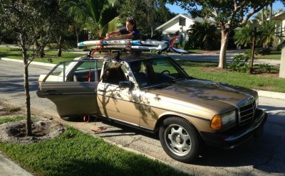

Nothing lets you blend into the Palm Beach crowd as seamlessly as driving a Mercedes. Photo courtesy of Bryan Cockfield

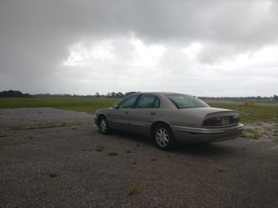

Buick Park Avenue: the last repairable luxury car? Photo courtesy of Bryan Cockfield

    2. “vintage VWs famously could not go up a hill.” That’s not strictly true. In the early 1980s I drove my Beetle up a substantial unpaved (grass) hill covered with snow with a layer of ice on top. It was quite peppy and went up the hill diagonally with the rear point at about 8:30 and the from pointed at about 2:30. Real paved hills were also not a problem.
      1. “pointed” & “front”. Sorry about that Chief. Missed it by that much. In this context, would an Edit button kill you, HaD?
      2. In 1945 the lowest powered VW beetle was only 25 HP and truly could not maintain highway speeds up even moderately steep hills.
        1. Very few VW enthusiasts are daily driving WWII era bugs.
          The 1928 Chevrolet Series AB national was last model before chevrolet phased out 4 cylinder engines for a few decades. It weighed 2,435 pounds and had a 35hp motor. ~70#/hp
          The VW Beetle was first imported to the US in 1949, with only two sold that year. Those weighed in at 1,600 pounds with a 25hp 1193cc engine. ~64#/hp
          Annual sales grew significantly breaking 100,000 by 1958. The Beetle achieved its peak sales year in1968 with 423,008 vehicles sold in the US. By that point they were ~1808# and were equipped with a 44hp 1493cc engine. 41#/hp
          The 2011 New Beetle (which is basically a stylized beetle replica on a Jetta chassis) weighed in at 2,983 lbs with a 150hp (nonturbo) 2.5L engine. 19.88#/hp
          I drove a 69 beetle in colorado during the early 90s. I cant deny it struggled going up to Estes Park, but so did the 91 escort I drove there a decade later. There were plenty of other mountain roads that both cars ate without a problem.

  11. Amen! Poring one out for my metallic blue 1979 Mercedes 230E (RIP, my own youthful fault), and I will give my 1999 Toyota 4Runner a pat today (240k miles and still going). I’m not much of a wrencher, but I sure appreciate reliability.

  22. My wife drives a 1989 Buick Park Avenue 100 miles daily to work. We purchased the car in 2011 and she has put 200k miles on it. We just keep maintaining it, fixing stuff, and it keeps giving back. They might have been considered old people cars, but they were some of the best engineered cars GM ever built. I suspect no vehicle made today will still be daily drivered 36 years from now.
    1. Those engines are legends.
      Go 200k miles with sand in the valve cover.
      GM’s mistake, they won’t do that again.
      But they know how.
