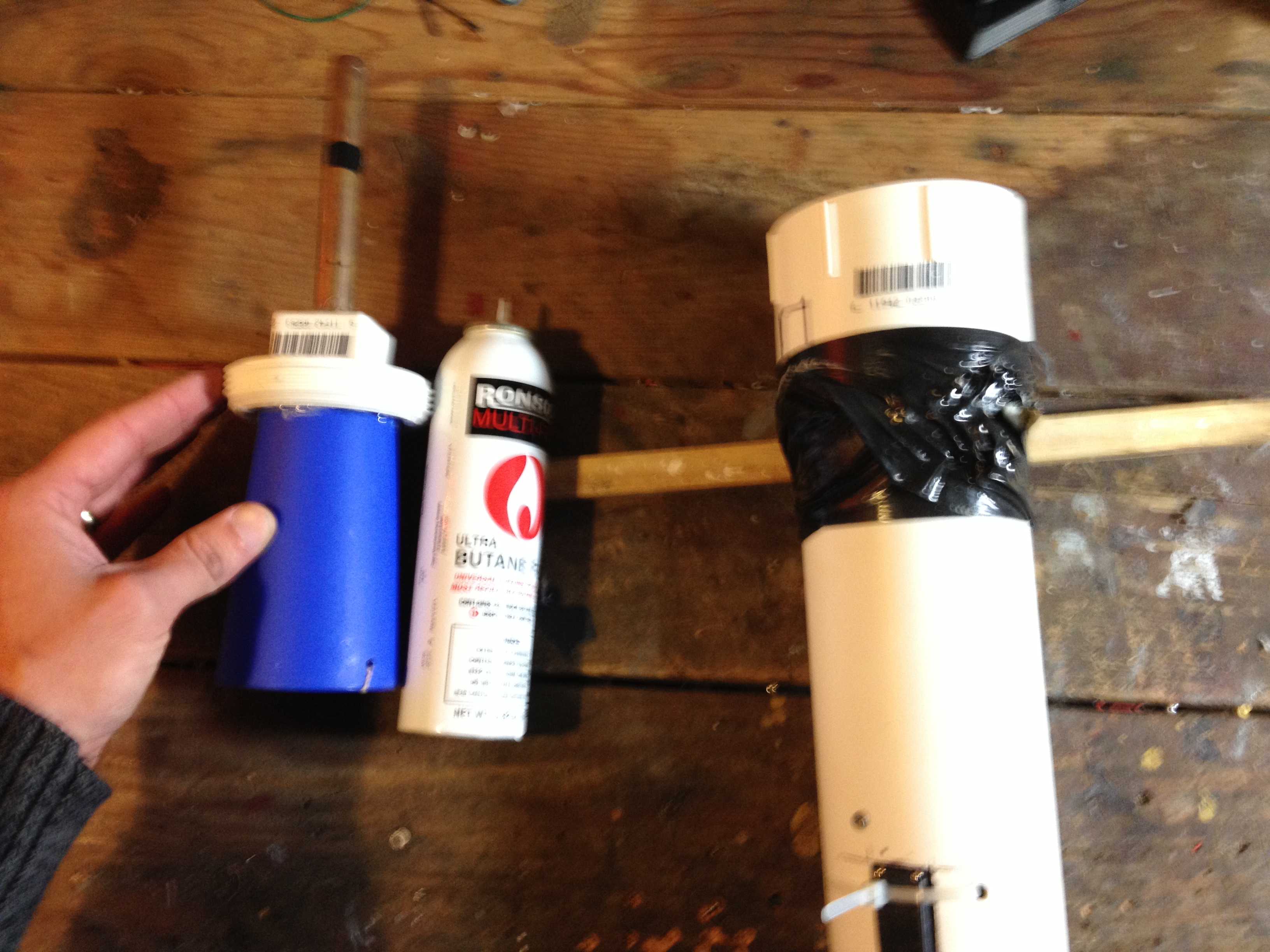

My plan then changed to be able to use this indoors. I wanted a flame, but not a massive column of fire. To do this I used small bottles of butane in a cobbled together dispenser.
There is a large piece of PVC, with a servo and plunger mounted in the bottom. The cap has a small hole in the top of it, with a long brass tube extending out. The butane bottle is guided into the hole with an old plastic cup, then the whole thing is screwed into place. You can see a small rubber band keeps the butane bottle pushed into the hole, so it doesn’t drop out and just fill the chamber with butane.
When I pressed a button, the servo would push the bottle upwards, releasing butane into the brass tube. Extremely simple, extremely effective. I really liked the fireballs this produced.
When I showed it to people outside though, the first response was that they were expecting a little more fire. The size of the plant itself made the little fireballs a bit underwhelming. So, I built basically the same system to fit a can of carburetor cleaner. Again, horrible idea, completely unsafe.
The carb cleaner did not dispense cleanly, no matter how I tried to adjust the mechanism. Highly flammable liquid sprayed EVERYWHERE including down the sides of the bottle. Luckily I tested this outside of the plant. It was a complete failure and I got a chance to use that fire extinguisher.

The final outdoor fire system I used took a total of about 15 minutes to make. It is a cylinder, with a hose attached to it. You put creamer (fine powder, not liquid, obviously) inside it. A blast of compressed air shoots it upwards, through the flame of your choice, causing a rolling fireball. There’s a knot in the hose to stop the creamer from pouring all the way down. I’m sure there were a million other ways to do it, but this worked.
While the construction was easy, the implementation wasn’t so straightforward. I found that in many cases, less is more. Too much air pressure simply sprayed creamer everywhere with no fire. Too much creamer would ignite, but then fall while still on fire to the ground, or the plant. A quick puff of roughly 30lbs pressure and about a quarter to half cup of creamer gave me some nice fire balls that easily went 10 feet upwards.
