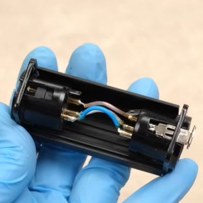

When [Denki Otaku] bought a ¥1,200 (roughly €6.5) XLR ground loop isolator off Japanese Amazon, he initially didn’t suspect that anything was off. Since they’re fairly simple devices, with basically a 1:1 transformer per channel in some kind of enclosure, the price wasn’t unreasonable.
That’s before a teardown showed that this ‘ground loop isolator’ actually contains direct wiring between the XLR sockets, but that doesn’t mean that you cannot still make an educational video about the real devices.

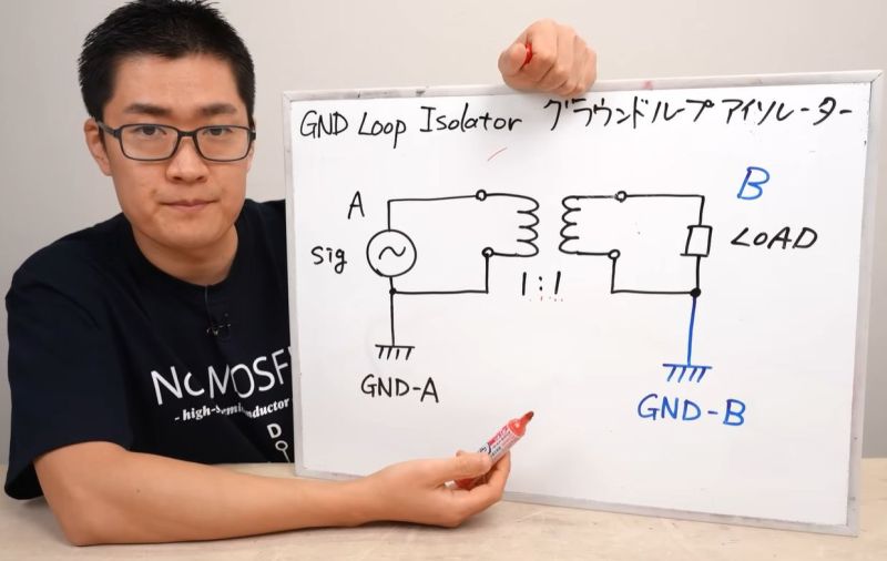

First the basic theory is explained, before the fake ground loop isolator is subjected to an analysis, showing why you’d want to use the real deal. Of course, detecting a fake one is pretty easy, as a simple continuity test with a multimeter  or similar will show that DC passes right through the fake isolator.

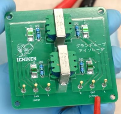

Next a real ground loop isolator was designed with a custom PCB and a high-pass filter added to the feature list. Here rather than a very basic filter with cheapo parts there was definitely some gold-plating going on, but it does show what you can do in addition to just adding a few simple transformers for ground isolation purposes.
The finished ground loop isolator device is pretty large, and would definitely require a larger enclosure than the homeopathic device, but it makes for an easy test bed with convenient access during the subsequent analysis.
Here each of the two channels has its own transformer and filter, with an initial test just by ear making the injected 2 kHz noise signal appear to go completely away.
Next, an oscilloscope is used to visualize the functionality, with the non-isolated 440 Hz test signal first shown with and without the injected noise, showing the clear impact of the noise and subsequently the isolator.
Of course, high-frequency noises will still pass through the transformer via parasitic capacitance leakage between the windings, so it’s not a silver bullet. Here the analysis at the end of the video shows the noise-rejection characteristics of these isolators, and why adding a high-pass filter makes a lot of sense. Finally, the scam device’s XLR connectors were reused in an enclosure for this custom board, giving it some purpose after all.

  1. With a symmetrical signal they could at least have omitted the ground pin connection, thereby making it a “ground lift” adapter. Then it’d at least have been theoretically useful.
    1. A differential signal would not be disturbed by common mode noise, but wouldn’t that stress the input and output of the devices by moving the ground loop current there instead? I mean, if it’s designed for that, all is well, but if you’re trying to mod an audio device for a “floating” output by disconnecting the ground, the output has to absorb the current and the input of the receiving device must pass it.
      1. In a differential/balanced circuit, there is ideally zero “ground” current and it is not ground referenced. All of the current should be differential between the + and -. There is no need for ground current to flow between devices- it should not. The connection only serves to create a continuous shield. There’s no electrical stress in breaking that ground. Most quality audio equipment will have a ground lift switch for this purpose. If there’s any significant current on the shield, you have other problems.
        1. ^ ^ This
          Ground loop isolation just requires breaking a ground connection so there’s no longer a closed loop in which unwanted currents can circulate.
          Full transformer isolation has its uses, but transformers are not required just to break ground loops.
        2. There is no need for ground current to flow between devices- it should not.
          That’s true, but here we’re assuming there is a ground current flowing between the devices that causes the need to “solve” the situation by disconnecting the shield ground between them. If my intuition is correct, this would simply shift the ground loop current into a common mode current in the differential pair.
          1. For instance, in an older house with outlets grounded to neutral, a load on the circuit causes different outlets to have different ground voltages. If you connect a shielded cable from one device in one outlet to another across the room in a different outlet, you’ll see a little spark as the ground levels try to equalize.
