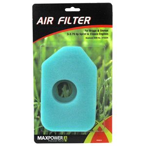

Ok, Now this has me thinking a tiny bit. I’m wishing for a way to make reproduction, “obsolete” foam, filter elements for older Briggs & Stratton engines..
goofy thought, but what if I soaked an appropriate type and size block of foam and then either milled (doubtful idea for a handful of reasons) or a well shaped, wire bristle wheel to do the stock removal.
Or has anyone got a link to some pourable **open cell** foam
that is gasoline and oil tolerant And wouldn’t cost over around $10 USD for the materials. I realize some kits of stuff might not come in a size that matches the job and you’d have waste or figure more usage per kit or just get over it! I would build my own form, So not concerned over that cost. The factory elements usually break down/crumble after about 5~8 years.
Briggs has superseded to a chintzy universal sort of replacement filter now , but it’s an entire housing change and closure VS the old style and it’s NOT nearly the dirt tight product that a Properly Maintained, old style one was.
The geometry of the filter is what makes the challenge to cutting one. It’s not a square block. Hopefully these pics link and show.
The foam block has a flange or lip around the outer perimeter on side These lips are absolutely CRITICAL to sealing to housing from dirt entering & bypassing the element. Then the center hole also has a flange of similar thickness and with same importance.
http://contentinfo.autozone.com/znetcs/product-info/en/US/max/334314/image/3/
http://ecx.images-amazon.com/images/I/41z68HvTTnL._SS380_.jpg
Hopefully the pics show and those lips/flanges are evident and maybe my long winded prattling was worth it.
Lacking that cure, The next thing may be trying to “cad” up a file to 3d print an entire new type of intake the accept the disposable paper ones. But those just get expensive very quick in dusty/dirty conditions. You can only do a few (partiality effective) dirt cleanings before the pores are totaly clogged.
That is a very common filter that is available at most outdoor power equipment shops.
Itlookslike one for a B&S 2hp L head engine. There are a lot of theses styles with different clipped corners and positions of the hole. The key to getting the right one is to bring the filter housing and cover with you.
At the expense of straying further off topic: if you track down the filter element, your only given the entire air cleaner assy. No option of the element only. instead of an $8~10USD element, your at $68+
and notice that given element will NOT work/function properly in that housing.
If you pull and pack it in there it will leak around and if you did manage to catch the sealing lip in the cover, it will tear loose in a few hours running time.
I used to be a repair “tech” many moons ago and have seen it more than once.
If you try to follow some of the other numbers, they seem to have been reassigned. ….sigh I’m just gettin old and so is my “treasure” :^( If the 5hp horizontal shaft ever does go back in service, it’ll probably be converted to a paper element from an I.C. series.
The vertical shaft ones are the bigger problem. Direct drive/mount blade rotary mowers like to rattle those dry type canisters loose. Even with well balanced blades.
