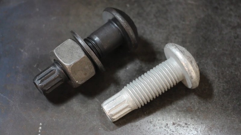

We’ve taken an in-depth look at bolted connections before, but for the TL;DR set, the short story is that bolts are essentially really strong springs. When you tighten a nut on a bolt, the bolt stretches a bit, which provides a clamping force on whatever is trapped between the head of the bolt and the nut. The degree of stretching, and therefore the amount of clamping force, depends on the strength of the material used to make the bolt, the size of the bolt, and the amount of torque applied. That’s why most bolted assemblies have a specified torque for all the bolts in the joint.
For structural steel, joints between framing members are carefully designed by structural engineers. A host of calculations go into each joint, resulting in detailed bolting plans. Some joints have a lot of bolts, sometimes 20 or more depending on the application. The hole pattern for each member is determined before any steel is cut, and each framing member usually arrives from the fabricator with the exact number of holes specified in the plan. The plan also specifies which grade of TC bolt is to be used on each joint — more on that below — as well as the diameter and length of each bolt.
Typical tension control bolts. The internal socket on the shear wrench grips the spline feature at the far end to counter the torque applied while tensioning the bolt, then twists it off. Source: LeJeune Bolt
As ironworkers build the frame, they first use a spud wrench to line up the bolt holes in the two members they’re bolting together. A spud wrench is a large open-end or adjustable wrench on a long handle that tapers to a point. The handle is used to drift the bolt holes into alignment while the ironworker inserts a TC bolt into the other holes. The bolts are initially just hand-tightened, but a critical part of the assembly process, called snugging or pre-tensioning, follows.
Snugging is somewhat loosely defined as the tightness achieved “with a few impacts” of an impact wrench, or “the full effort of an ironworker” using a standard spud wrench. Everything about snugging is very subjective, since the number of “ugga-duggas” that count as a few impact wrench blasts varies from user to user, and ironworkers similarly can apply a wide range of force to a wrench. But the idea is to bring the framing members into “firm contact,” which generally amounts to about 10 kps or “kips”, which is 10,000 pounds per square inch (about 70 MPa).
Once all the bolts in the joint are pre-tensioned, final tensioning is performed. The tool I saw those ironworkers using on TC bolts all those years ago goes by many names, with “shear wrench” or “TC gun” being the most generic. It’s also known as a “LeJeune gun” after a major manufacturer of TC bolts and tooling. Some shear wrenches are pneumatically powered, but more are electrically operated, with cordless guns becoming increasingly popular. The final tightening cycle begins by engaging the TC bolt spline with the internal socket and the nut with the outer socket. The outer socket tightens the nut to a specified torque, at which point a slip-clutch shifts power transmission from the outer socket to the inner socket, reversing the direction of rotation in the process. This applies enough torque to the spline to twist it clean off the TC bolt at the weakest point — the narrowed neck between the spline and the threaded section of the bolt. This leaves the bolt properly tensioned and with just the right amount of thread showing.
Tools of the Trade
TC bolts generally come in two grades: A325 and A490. Both are based on ASTM International standards, with A325 bolts covering the tensile range of 120 to 150 kps (830 to 1,040 MPa), and A490 covering 150 to 173 kps (1,040 to 1,190 MPa). Most TC bolts have a rounded head, since there’s no need to grip the bolt from the head end. That provides a smoother surface on the head side of the joint, making it less likely to get damaged during installation. Depending on the application, TC bolts can be treated to prevent corrosion, either with galvanizing or a passivated treatment.
If a TC bolted joint needs to be taken apart, the fact that the spline has already been snapped off presents a problem. To get around this, a special accessory for the wrench known as a reaction bar is used. This is essentially an inner socket sized for the nut and an outer ring with a sturdy torque arm welded to it. The arm jams against an adjacent nut and provides the counter-rotation needed to loosen the nut.
Lot testing is also very important for code compliance. This involves picking random TC bolts from every lot to test on a Skidmore-Wilhelm machine, which hydraulically measures the tension on a bolt. Strict procedures for pretensioning and final tensioning of each bolt are followed, and results are recorded as part of the engineering records of a structure.

  1. This seems to require that the friction of the rotating bolt be the same for each joint. Wouldn’t a better way be to measure the elongation of the bolt?
      1. It is true that fiction (both between nut/washer and in the threads) plays an important role – leading to variations on the preload even for the same tightening torque. As suggested, measuring elongation is indeed a more accurate way of determining preload, but is hard in practice (as Elliot mentions). I believe that in some high-end applications this is done using ultrasound during tightening.
        1. There are bolts with a small hole bored through the middle about half-way through, and a strain gauge glued to the inside of the hole to measure the elongation of the bolt. The strain gauge is a “relatively” cheap way of doing it, if you absolutely must have equal known tension in your bolts.
      2. I thought of measuring elongation by the number of turns after snugging, and in fact this has a name – the Turn of Nut method. https://www.gwyinc.com/turn-of-nut-method/
        Friction can vary some without keeping you from finding the point of snugness. So once you are snug, from that point the threads per inch of the bolt is a fixed quantity and you can rotate through a fraction of a turn and get that much extra elongation.
      3. Ultrasonic extensometer, measures from one side. Pretty common in the non-destructive testing (NDT) industry. I used one once to tighten the head bolts on an ICE engine after replacing the head gasket. Much more accurate than a torque wrench.

      2. Notice that they turn back to red from black if they become loose. This means that you can visually inspect them periodically to ensure that they are all still torqued correctly. I can imagine a lot of safety critical applications where you have bolts that are easy to see, but not easy to get to. Think about bolts inside an airplane. It would be easy to view them with a boroscope, but removing enough parts to get at them would be very costly.
    1. There is an accepted method for essentially doing this to standard structural bolts. The AISI “turn of the nut” method requires a set rotation of the nut beyond the snug tight point, which corresponds to a set elongation since the thread pitch is known.
    2. All bolts torqued to a spec are to trying an induce a particular pre-load on the bolt, which would result in a specific elongation. Direct bolt elongation measurement would be preferred, but how would you do that in the field? The answer is that you can’t, not in a way that allows you to place thousands of bolts in a reasonable time frame. So torque measurement is your stand-in for that. The axial load to torque relationship is very much affected by the friction between the various surfaces. There are numerous methods designed to make field torqueing (and inspector verification of that torqueing) of bolted connections faster; indicating bolts, indicating washers (called “squirters)”, TC bolts, etc. It still isn’t perfect (I’ve found loose bolts in structural connections), but it works well enough.

  4. “The outer socket tightens the nut to a specified torque, at which point a slip-clutch shifts power transmission from the outer socket to the inner socket, reversing the direction of rotation in the process.“
    I don’t follow the reasoning here. The tool has a gun shape; the operator is not going to be able to apply much torque themselves. So the tool is torquing the nut and the bolt relative to each other. So if the direction of rotation (that is, of the bolt and nut relative to each other) is reversed, doesn’t that just mean the bolt gets unscrewed?
    Put differently: does the slip clutch slip before or after the shearing torque is reached? If before, how does it get sheared off? If after, why have a slip clutch?
    1. There’s likely no clutch, or torque setting on the tool at all. The gun doesn’t turn because the clockwise torque applied to the nut is countered by a counter clockwise torque applied to the bolt. The end of the bolt shears off when the torque gets high enough to shear it off. That torque is designed into the bolt itself.
      1. Yeah, that was my take as well. Still, presumably Dan Maloney actually did research for this article, so it’s hard to square that with his description.
        1. Maybe he meant differential, rather than clutch? The thing would need a differential to keep it from twisting the operator’s wrist off once the bolt sheared off. But slip clutch is pretty specific…
          1. Maybe a clutch could be part of it, if there’s a kick when it shears and starts spinning.
            As for a differential, the way I’d design something to get something to counter-rotate on the same axis at the same speed is to drive the carrier of a planetary gearset with a motor and put the spline on the sun and the socket on the ring. (Well, do that after a gear reduction, anyway) That’s already got differential action. Even once the sun starts turning very fast because it’s sheared, there’s going to be some force trying to rotate the ring because it can’t reach infinite speed with friction and such, I would think. I wonder if that torque is enough to need to clutch out to save their wrist? It’s not my specialty, but if there is one that may be why.

  5. Minor nit: the reaction bar is solely to allow use of a powered wrench without the operator having to provide the reaction force (important when you’re up on a scaffold or suspended in a harness) and works identically for TCBs and regular hex bolts. The reaction bar will do nothing when a TCB has had a nut freeze onto the bolt – the bolt & nut will just spin in the hole no matter how fancy a tool you use. The solution is the same as any bolt: cut a head into the opposite end to hold it in place, cut one head off and pull the remains through, or drill the thing out.
  6. You will see TC bolts on buildings but probably never see them on bridges. Instead of being called “tension control” they should be referred to as “torque control”.
    A dry (unlubricated) bolt requires more torque to turn the nut and it may not get the tension required to bring the layers together tight. A dry TC bolts can snap after reaching the it’s torque value and appear to be good but in reality did not get the proper tension.
    To make matters worse, the code does not allow one to lubricate TC bolts in the field.
    With most buildings, it may not be critical but it is for bridges. The difference is the static loads on most buildings compared to the cyclic loads on bridges.
    Bridges use Direct Tension Washers (DTI) washers, some times refered to as Load Indicating Washers. DTI washers can be verified in the field that they have the required tension even if the bolt was dry.
    DTI washers have protuctions that requires the bolting crew know which side the protuctions go on. That plus the right size feeler gauge to measure the gaps between the washer and structures once the protuctions are compressed. Need to keep on eye the bolting crew that might be tempted to hammer the protuctions flat before installation.
    Another alternative is the “turn of the nut” method to ensure you are getting proper tension. It does require the bolt up crew is properly trained on how to “match mark” the turns. Many steel erectors do not which leaves the bolting inspector questioning if it was done properly.
    The code does not prohibit bolts from being lubricated in the field if DTI washers or if the “turn of the nut” method is to be used.
    I recommend lubricating bolts with a wax based lubricant to get better tension for less torque.
