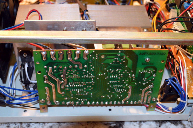

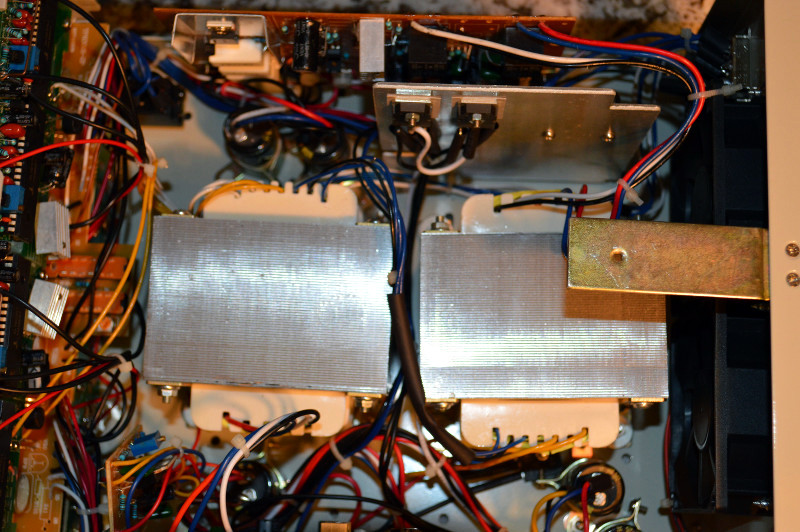

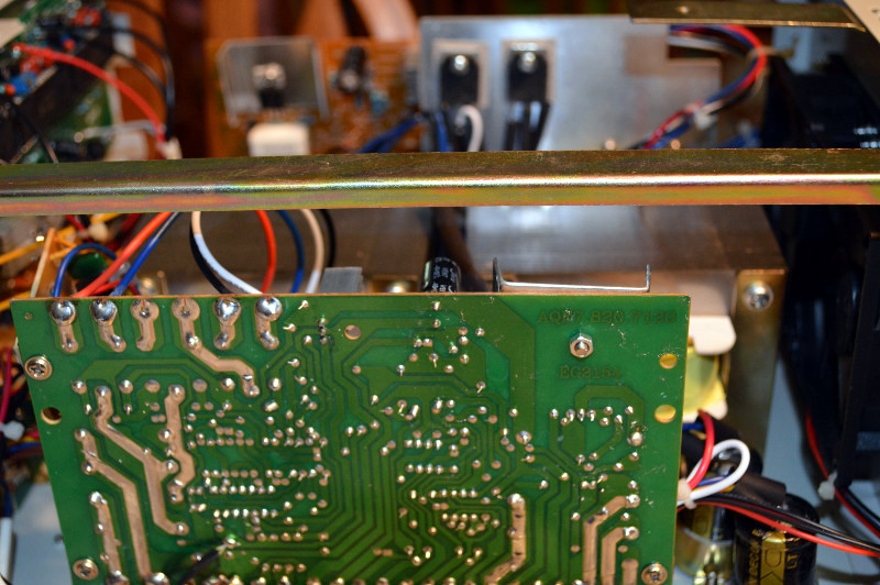

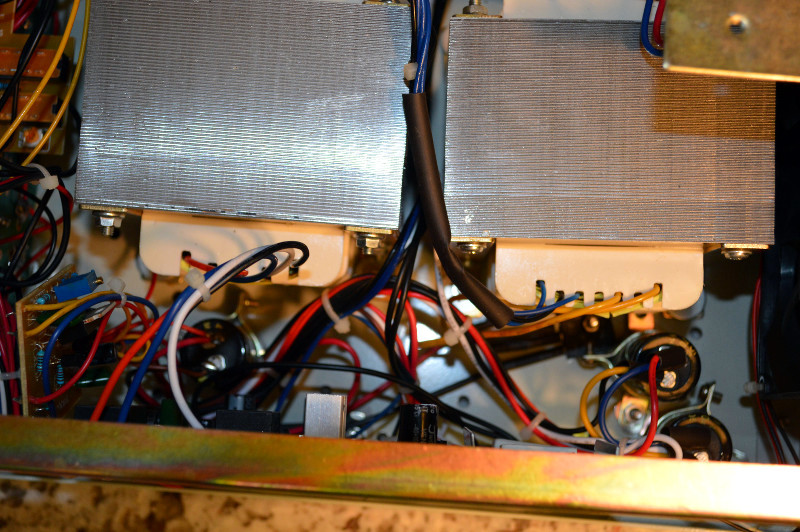

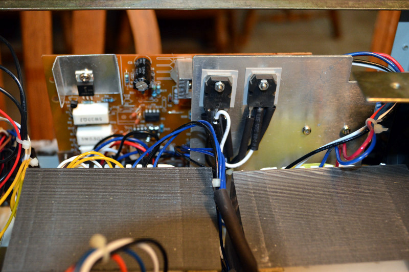

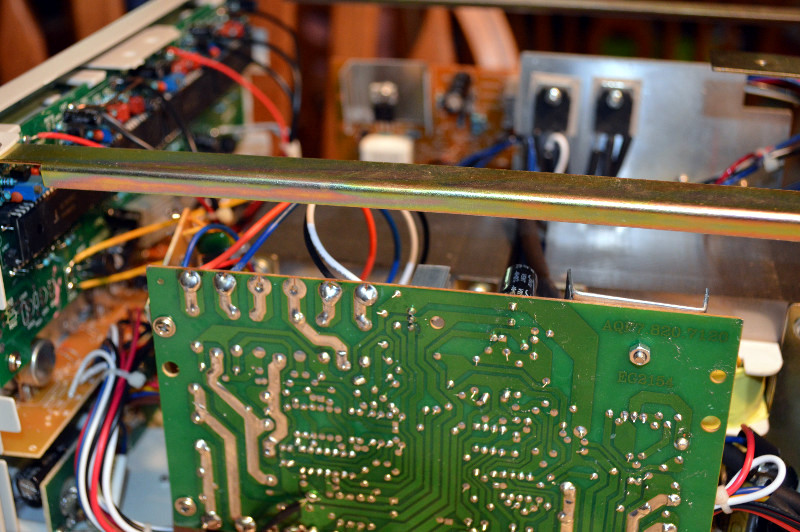

Inside
You can see some photos I took of the inside of the unit in the gallery below. The transformers are big and heavy. If you want to take one of these apart to adjust the displays or repair, it is good to know the handle’s back bolt attaches to the main chassis. So in addition to the eight bolts on the sides (four on the left and four on the right) that back bolt has to come out, also.
The build quality is about what you’d expect from something at this price point. I’ve heard people say, however, that the build quality of this class of power supply can vary wildly, so maybe this one sample point is not enough to draw a conclusion.
