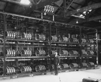

Julius’ first commercial automatic tote was installed in 1913 at Ellerslie racetrack in Auckland, New Zealand. The machine was so large that it required its own multi-story building called a tote house. The Ellerslie machine could perform simultaneous bet summation for up to thirty horses. It displayed in real time the approximate odds for each horse to win, the total running amount wagered on each horse, and a grand total of wagers made in the event. The first floor of the tote house had thirty ticketing windows where bets were placed. The rest of the building was devoted to totalisator machinery. The tallied bets and approximate odds were displayed in the second floor windows of the tote house. These numerical displays were actually a part of the machine—huge, readable numbers on counter wheels.
This first automatic totalisator was completely mechanical and operated similarly to clockwork. Power came from large iron weights attached to bicycle chains draped over drive sprockets. The Ellerslie machine was only used for five years before it was replaced by an electromechanical tote. This marked the beginning of Auckland Totalisators Limited (ATL), which went on to dominate the international market for the next 50 years.

The betting process begins when a ticketing agent pulls a lever corresponding to the horse chosen by the bettor. This lever tugs at one of the 900 steel wires running overhead—one wire per horse, per ticket window at thirty apiece. You can just make them out in the upper right corner of this picture. Bets were taken in the smallest monetary units, and each pull of the lever incremented the bet.
In order to convert the parallel input from all the ticket windows to serial tallies for each horse, Julius invented a mechanism he called a shaft adder. The totalisator at Ellerslie racetrack had one of these mechanical differential adders for each horse. A shaft adder consisted of several sets of epicyclic gears situated along a common shaft. An escapement wheel attached to each gear set prevents it from rotating freely. The shaft adders are summed together to form the running grand total, which is displayed at the top of the tote board. A separate mechanism gave approximate odds using the horse’s current bet total, the current grand total, and some trigonometry.

Tote boards quickly became electromechanical. Instead of large weights, the counters were driven by motors. Multiplexed rotary switches allowed the ticketing machines to share an escapement wheel on the shaft adder.
ATL installed totalisators all over the world, completely dominating the market until digital computers made them obsolete. Tote boards were among the first real-time multi-user systems, and helped pave the way for parallel processing.
