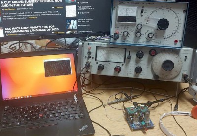

The Hackaday audio test bench. On the left, Thinkpad laptop, on the right, distortion analyser with audio oscillator on top of it. On the bench in front of the analyser, a small PCB that's the tube amplifier.
The Hackaday audio test bench in all its glory.
Having explained what we are trying to do, it’s on to the device in question and the instruments required. On the bench in front of me I have my tube headphone amplifier project, a Chinese 6J1 preamp kit modified with transformers on its output for impedance matching. I’ve investigated the unmodified version of this kit here in the past, and measured a THD of 0.03% when it’s not driven into distortion, quite an acceptable figure.
To measure the distortion I’m using my audio signal generator, a Levell TG200DMP that I was lucky enough to obtain through a friend. It’s not the youngest of devices, but it’s generally reckoned to be a pretty low distortion oscillator. It’s set to 1 KHz and a 1 V peak-to-peak line level audio output, which feeds the headphone amplifier input. The output from the amplifier is feeding a set of headphones, and my trusty HP334A distortion analyser is monitoring the result.

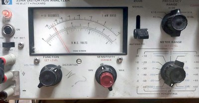

Part of the front panel of the HP 334A, showing a large panel meter and a set of dials.
The business end of my trusty HP.
A distortion analyser is two instruments in one, a sensitive audio level meter, and an extremely high quality notch filter. In an instrument as old as this one everything is analogue, while in a modern audio analyser everything including the signal source is computer controlled.
The idea is that the analyser is first calibrated against the incoming audio using the voltmeter, and then the filter is switched into the circuit. The filter is then adjusted to reject the fundamental frequency, in this case 1 kHz, leaving behind only the harmonic distortion. The audio level meter can then be used to read the distortion. If you’re interested in how these work in greater detail I made one a few years ago in GNU Radio for an April Fool post about gold cables.
Using the HP offers an experience that’s all too rare in 2025, that of tuning an analogue circuit. It settles down over time, so when you first tune it for minimum 1kHz level it will retune to a lower level after a while. So mine has been running but idle for the last few hours, in order to reach maximum stability. I’m measuring 0.2% THD for the headphone amplifier, which is entirely expected given that the transformers it uses are not of high quality at all.
