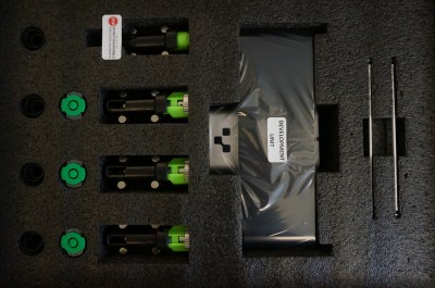

Unboxing
The V-One arrived in a big brown box, with its many parts secured in foam packaging. The included Quick Start Guide pointed me to the Voltera Start Page which gives step-by-step instructions on the unboxing, assembly, and setup of the printer. This mostly requires loading syringes into their holders, and installing the V-One application onto your PC.

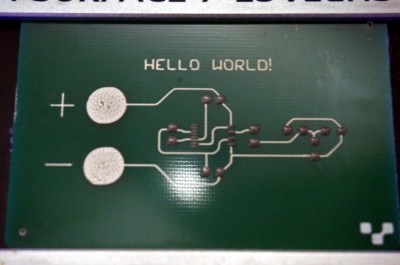

Opening the Voltera V-One app, you’re greeted with the “Hello World” circuit. Voltera ships the components for this simple board with the printer. It’s a little blinky LED design, consisting of a 555 timer, some LEDs, resistors, and a 9 volt battery.

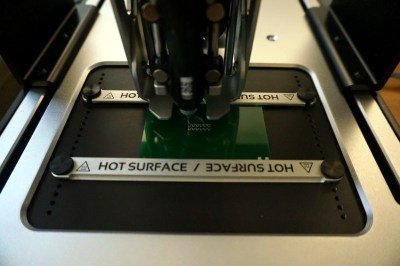

The printing process has a number of steps, which the software guides you through. The videos included within the app are a nice addition, as they walk you through every step visually.
After clamping a blank board onto the printing bed, the printer needs to be calibrated. This process lets you tell the printer where to print, then allows it to zero the axes. It took about 2 minutes for the probe to run around the board and calibrate the Z axis.
Once the axes are calibrated, you load the conductive ink in and calibrate again. This calibration ensures that enough ink is dispersed to make continuous lines, while not causing those lines to overlap. The conductive ink is the equivalent of copper traces on a normal PCB, so the goal here is to ensure good connections and prevent short circuits.
Next, the conductive ink is printed. This took about 7 minutes for the Hello World board. The machine makes some nice stepper motor sounds as it lays down conductive ink. I had some calibration issues, and ended up with traces that were not solid. I fixed this by manually placing some conductive ink onto the board. It’s clear that calibration is one of the biggest challenges of this product, and it takes some attention to make sure it’s right.
With the conductive ink on the board, it was time to bake it. This requires flipping the board over, and letting the V-One heat it up to about 220 degrees Celsius. The baking took a total of about 30 minutes, with another 10 minutes to cool off. The final step is to scrub the board with an included burnishing pad to prepare the surface for soldering.

With the paste on, it’s time to break out the tweezers and place the components. Hitting the reflow button in the app automatically starts heating the bed according to the reflow profile.
The automatic setting is designed for the paste provided with the printer, but there is also a manual mode for doing your own reflow profiles. The solder paste dispensing and reflow combination is a nice alternative to solder stencils and toaster ovens.

I’m now destroying my Hello World board. The ink is stronger than expected. I can’t get any of the SMD resistors off by pulling straight up on them.
I cracked off some SMD components by smashing them against the edge of a desk. This broke the solder to ink connection, and didn’t actually remove the ink from the board. I’ll be testing with a real connector soon.
