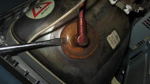

It is important to state immediately that the final anode voltage on a CRT is likely to be somewhere over 20 KV depending on the tube, and can be considered not merely dangerous but lethal. The glass funnel behind the screen of a CRT forms the reservoir capacitor for this EHT power supply, and can hold that 20 KV charge for long after the TV or monitor has been powered down. So you have to treat these devices with a lot of respect, for they can kill you.
That said, this should not stop you working on a device with a CRT in it. The designers of CRT circuits were aware of the hazards, and made sure that those EHT voltages were safely locked away where they were very difficult to touch. Take a look at the picture above showing the monitor components of a Mac Plus, the EHT circuit is the red cable and big round red sucker on the side of the CRT in the foreground. All the high voltage is safely contained behind that red insulation, and if you do not attempt to remove that connector from the side of the CRT it will remain there in a perfectly safe condition while you look at the other parts of the device.

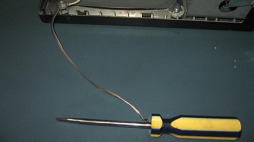

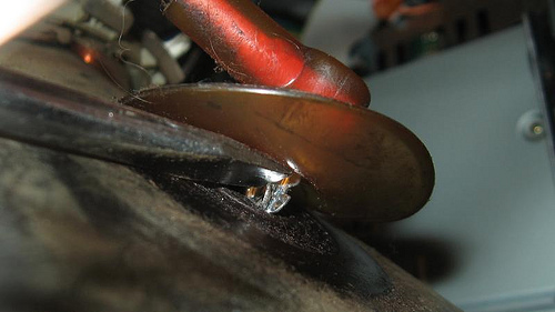

In the unlikely event that you find yourself needing to remove a monitor or TV chassis from its CRT it is quite straightforward to discharge the CRT anode capacitor, however it is a procedure that must be performed with some care. Your aim is to discharge that anode connector to the black outer coating of the tube, known as the aquadag. To do this you will need to find a large flat-blade screwdriver with the thickest plastic handle you can. That handle is going to protect you from over 20KV for a short time.
You will need to connect the metal part of the screwdriver with a piece of insulated wire to the earth connection to the tube which is normally somewhere on the metal band that goes round the edge of its face. This is probably best achieved with crocodile clips on the end of your piece of wire. Then you simply hold the screwdriver by its plastic handle, and gently slide its tip under the rubber sucker covering the anode connector until you hear the “crack!” sound of it discharging. Then to ensure it’s really discharged, wait a few minutes and repeat the procedure, repeating it again after you’ve removed the connector. (Images from [Ax0n]’ CRT tutorial.)

  2. How does the plastic on the screwdriver protect you? If you don’t hold the wire in one hand and the screwdriver in the other you would be ok right? From what I gather high frequencies and very high voltage don’t care about insulators. Obviously you shouldn’t play with things you don’t understand but how do you come to understand them fully without working with them?
    Was it Nikola’s rule work with the left hand in the pocket, and use the right to manipulate?
    1. Technically you are correct. If the screwdriver is properly grounded via the wire you attached then the 20KV from the TV would have no motivation to go through you; you would be fine without the insulation. This is not due to frequency in any way which is, in turn, related to capacitance… it is only due to your large body resistance vs the very low resistance of the wire. In the tv scenario above, we are discharging a capacitor so this implies DC….again, frequency doesn’t come into play here.
      In reality, there could easily be a scenario where you forget to attach the ground wire to the screwdriver or the wire comes unclipped. In this case you better hope the screwdriver has an insulated handle. The insulation *should* stop arcs up to around 20 or 30kv. Again, nothing to do with frequency.
      If you are working with high frequency, the screwdriver insulation would likely still be fine. The screwdriver metal – handle – hand capacitor formed has such a low value of capacitance you would need an incredibly high frequency signal to pass through it. I’ll leave research of capacitor displacement current and it’s effects on insulator materials up to you.

  7. Isnt it standard to use a 1Mohm resistor between the screwdriver and the ground, so it doesnt arc and collapse the field instantly and blow the end of your probe off but collapse it gently?
    1. Bearing in mind your resistor should be good to 30kv. Or 10x 100k resistors in series so eliminating the risk of arcing across a typical 1/4w resistor as theyre only rated to about 250v or so.
      I’ve got a discharge probe set up, but I play a lot with old arcade machines with crt’s in them.
      1. A FOAF story, probably mis-remembered from 40 years ago…
        My first boss told of the story where he was fiddling with an HT supply (probably in a TV) using an appropriately long screwdriver with insulated shank. Then “ouch”. He investigated – and found an almost invisible oil track up the shank and onto the handle.
