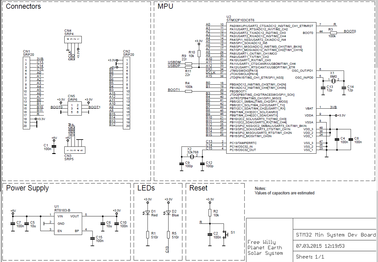

This Hackaday Prize entry is for an almost-clone of the Leaflabs Maple Mini. It sports a newer microcontroller, but still has the same bootloader and pinout. The best part? It costs less than four dollars.
The microcontroller inside this Maple Mini clone is the STM32F103, a 32-bit ARM Cortex-M3 running at 72 MHz with 128K of Flash and 20K of SRAM. That’s enough for just about everything you would want to throw at it. It also follows the pinout of the original Maple Mini, and the team also has a version that’s a slight improvement of the original Maple.
The big deal is, of course, the price of the board. It’s four bucks, or about the same price as an Arduino clone from the usual online retailers. Now, finally, there’s a reason for you to wash your hands of the Arduino too.

    1. Those “Blue Pill”-modules use wrong-sized resistor for USB, ie. they have a 10kOhm resistor connected to it. That’s easy enough to fix, though. Aside from that there isn’t any meaningful difference.
          1. According to the more-knowledgeable people of the Stm32duino-forums and e.g. the Maple Mini – schematics it should be 1.5kOhm (I do not have the knowledge of USB-specs to actually verify this or not, but my board didn’t work right until I replaced the resistor)
