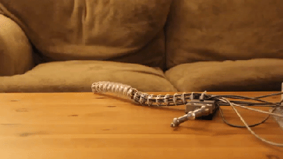

Our tentacle has two stages, each of which has two degrees of freedom. These two degrees of freedom enable that stage to arc in two directions, both orthogonal to each other.
With a linear combination (a mix!) of all four of these degrees of freedom, we get quite a bit of freedom to spoof some pretty convincing organic moves. If we watch the clip below closely, we can actually see the point where those two stages join, about half way down the body.
When it’s properly assembled, we can control each stage independently without influencing any curvature in the other… ideally. In the real world, nothing’s perfect, and our materials especially have their own limitations. With that said, we’ll need to refine our tension and vertebrae spacing until the behavior is good enough for us.
![tentacle_movin](https://hackaday.com/wp-content/uploads/2016/08/tentacle_movin.gif?w=400)
In an ideal world, tugging on the each stage’s cable would form a perfect arc that decreases in diameter the more we tug. Friction causes losses at every vertebrae, so we can’t achieve that perfect arc, but we can get close enough to fool those humans off-screen.
Keep in mind that, while we can achieve a range of poses, none of them involve twist along the tentacle core! This design choice is deliberate from puppeteers of the past who see it as unnatural–especially among the cat’s tails and elephant’s trunks that we may be trying to emulate [1].

To get some intuition of the cable drive, let’s build up a crude tentacle consisting of two plates, and a flexible core. Here’s a diagram of our pre-natal tentacle below:
By exhibiting a torque on the pulley, we simultaneously slacken one rope while tightening the other by the exact same length. The resulting shortened wire length curls the tentacle towards the wire. Since these cables can only apply force in tension, they must be paired with complements for the full back-and-forth range of a single degree of freedom. Hence, we have a messy grand total of 8 wires to manage later, but we’ll talk about cable management in the weeks to come.
The tentacle holds its pose because of two key features here. First, the cable conduit resists compression. Second, the cables are pre-tensioned and fixed rigidly to the pulley. Because a change in cable length is the only way to move the tentacle vertebrae and because the cable conduit cannot change length, keeping the pulley in a fixed position will likewise keep the tentacle fixed in its current pose.
The Role of Cable Conduit
The big player in this scenario is the cable conduit. Without it, movement in the upper stage would also cause unwanted movement in the lower stage, and that’s exactly what we don’t want. Instead, we’d like our two controllers to independently control each stage they’re connected to.
Cable conduit lets us freely reroute the direction of our forces from one end of the conduit to the other without causing any unwanted forces along the way. The key here is that conduit remains flexible while simultaneously resisting compression.
As an interesting phenomenon, in the setup above, we can grab this cable conduit at any point and move it about any way we like without any resistance for two reasons:

Tentacle Nuts and Bolts:
And now for another deep dive into a new vocabulary of parts. I promise that we haven’t made friends with these off-the-shelf components just yet, so keep a sharp eye and read on, fearless reader!
Core Material:
The key to achieving that slick, isolated movement from each degree of freedom comes from building the tentacle out of a structure that resists twisting along its core. Most folks tend to use replacement speedometer cables from old cars that do just that [1]. On my first few passes at these puppets, I too used speedometer cable. Unfortunately, these cables are limited to a single diameter: 0.125 inches, which means our puppets can’t get all that large without starting to twist under their own weight. These days, I’m finding somewhat better performance from flexible shafts for rotary tools, since they come in a slightly larger diameter. Heads-up: unless otherwise noted, most pics on this round, though, are using speedometer cable, which is fine for puppets that are fairly small and light.
Segments:
For each segment that will become our tentacle’s vertebrae, we need a way to rigidly affix that segment without slipping or twisting. These vertebrae serve to both properly route the cable and, where needed, cable conduit too, while they maintain their fixed location to the speedometer cable. Landon’s design solves this problem with an all-in-one CNC’ed alumimum piece. Luckily, with a little shopping online, I’ve mocked up a component that does the same thing but relies on mostly off-the-shelf components. The key to this element is all thanks to hackers like you. Since hobby robot parts are such a commodity item these days, I managed to create the vertebrae from just a Pololu motor hub with an extra Delrin plate to hold the cables at the right places.
Control Cable:
![bluing_steel](https://hackaday.com/wp-content/uploads/2016/09/bluing_steel.gif?w=400)
The cable actually driving these mechanisms is just as we’d expect to see on bicycle brakes: wire rope. These are far thinner, however. I’ve had luck with two varieties of the 7×7-core: the 3/64 inch (1.190625 mm) diameter and the 1/32 inch (0.79375 mm) diameter. The super-fancy flavor of this wire rope doesn’t fray since it’s annealed at manufacturing by squeezing it through an undersized hole [1]. Alas, I can’ t afford such goods, but a few folks at the Stanford Cable Mechanisms class have found a nice alternative. It turns out that torching the cable tip for a few seconds until it glows is sufficient heat treatment to prevent it from fraying [3]. Presto! Now our cables won’t fray.
Cable Conduit:
For the cable conduit, there’s a host of options that include nylon tubing, derailleur cable housing, and extension spring. At the end of the day, we’re trying to achieve one goal: we need a housing that resists compression while retaining flexibility. Our conduit needs to resist compression such that it provides that “equal-and-opposite” force needed to create movement.
It needs flexibility so that it also doesn’t prevent any of the other sections of the tentacle that it’s routed through from bending. For single stage tentacle mechanisms, any option from that list above will do. For multistage mechanisms, though, that flexibility is key. So far, I’ve found that extension spring really does the job best since it’s far more flexible than any of the other options.
I’m convinced that McMaster-Carr might be able to sell you just about anything. You just need to know the right name for it. Around those parts, our cable-conduit substitute goes by the name “continuous length extension spring,” (9664K12) and for $4.40 at 36 inches, I can’t complain!
If your needs are truly custom or you need something smaller, I’ve had some great luck getting smaller diameter springs fabbed from Dr. Templeman and Co. Their pricing for any lengths beyond their default 8-inch length will cost a bit more than McMaster’s 0.125-inch diameter, but the range of tiny sizes might just be worth the few extra dollars. Anything in the extremely tiny range might get you in conversation with the folks at Molex with their micro-miniature coils. Heads up: if you end up finding yourself picking up medical-grade extension spring, please drop us a line and send us some awesome pics of your project when it’s done!
