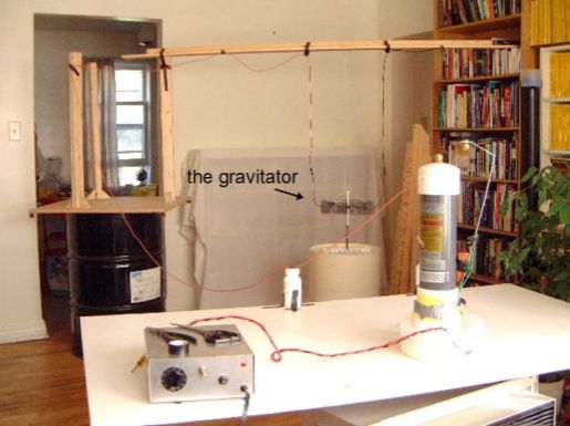

Gravitator
The gravitator capacitor was created by T.Townsend Brown to control gravity and is described in UK patent GB300,311. My implementation was a 30cm (12 inch) long chunk of Bondo resin with two aluminum electrode plates and 29 more isolated plates evenly spaced in between. In one of the photos you can see it under construction. It was made in two pieces, each with a white plastic mold into which a plate and resin was added. The resin then hardened, the mold was raised, then more plates and resin was added, and so on until each piece was half the length of the final capacitor. They were then glued together using more resin to produce the one long piece you see in the photo of the test setup.
The test was a horizontal one this time with the gravitator suspended as a pendulum. No movement was ever detected. However, usually when this test is done, one or both of the feed wires is a small diameter wire with a thin enamel coating i.e. magnet wire. At these voltages, that enamel breaks down easily and ionization to the air results, acting as a jet and creating some form of propulsion. We’ve seen this type of ion propulsion before when we talked about the homemade flying machines called lifters.
The movement is usually small but the experimenter typically cycles the power supply on and off in time to the movement, creating a resonance just as does a person on a swing when they pull on the ropes and swing out their legs at just the right time. The result is a big movement, but not one that has anything to do with gravity control. In my case you can see I use feed wires with insulation thick enough to avoid breakdown, and so I got no movement.
